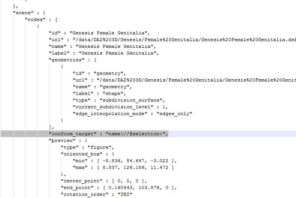

    The attached pic shows a chunk of code from the Genesis Female Genitals DUF, the highlighted line is what I've had to add to it, check your DUF files in a text editor and see if you have that line of code, you might have to uncompress them first.
    Without that code DS wont do what it's meant to, instead the CMS has to take up the slack.
    I can't speak about specifics as I've never done a geograft, but it's basically just a conformer, so it should fall under the same rules.
    791 x 530 - 168K

    Thanks for the info Bejaymac, that's definetely something I'm going to look into :)
