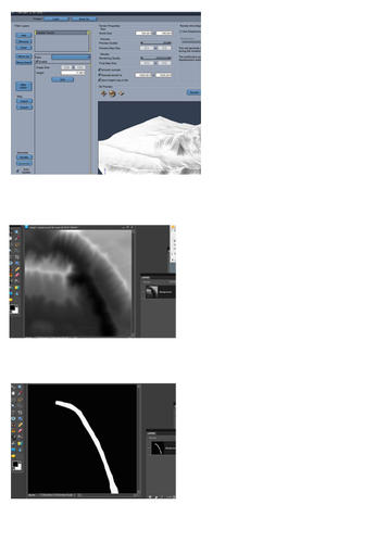

    1) Opened new file. Loaded terrain from object browser. Went into terrain modeler and exported the map as a .psd file.
    2) Opened Photoshop. Loaded file exported from terrain modeler.
    3) Painted black and white directly on the map to create a white line on a black background. (Just to make sure layers wasn't being a problem.
    4) Saved the white/black file as a .tif file.
    5) Back in Carrara, inserted a sphere and a surface replicator. Set the surface replicator to apply spheres to the terrain.
    6) In the surface replicator distribution channel, checked used shader.
    7) In the shader, set to multichannel and set to texture map. Loaded the .tif file exported from PS. made sure the color only box was checked.
    You can see the progression in the attached pics. Doesn't work.
    Argh.
    600 x 800 - 206K
    500 x 700 - 97K

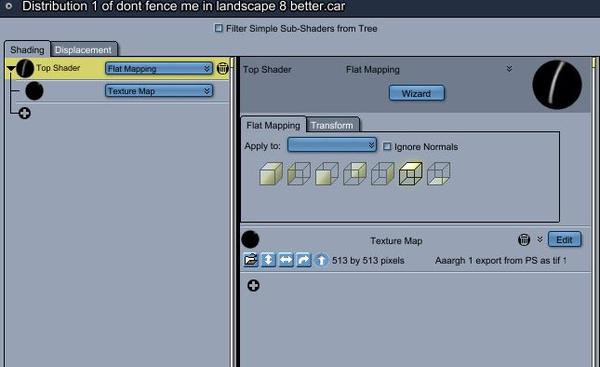

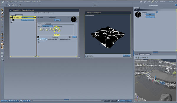

  • 3DAGE3DAGE Posts: 3,321
    HI diomede64 :)
    I think the issue is connected to the way you're setting up the shader (multichannel)
    Try setting the shader to Projection mapping / Flat mapping / then select the "Top Box" of the little box icons (see pic)
    As for the Photoshop white dots,. that's probably a format conversion issue as Evilproducer mentioned,
    Work-flow should be something like this
    Export terrain map, as PSD if you're using photoshop.
    Use the "magic wand" selector, (or another selection tool),. to select the area you want
    Create a new layer.
    Use Edit / Fill to fill the selected area with White or Black.
    you can create a New layer, filled with black as an Under-layer if needed.
    Export your B/W distribution map as JPG or PNG
    (remember that the imported distribution map will need to be rotated to fit the terrain)
    JPG and PNG are both much smaller in file size than Tiff or BMP
    Save your Photoshop file (with all your distribution or texture layers)
    Layers are your friend :)
    Hope it helps :)
    1651 x 967 - 256K
  • DiomedeDiomede Posts: 15,469
    edited March 2014
    3DAge! Thanks for the suggestions.
    My computer has been taken over by fans of Tron (original version). Paint is the master controller. I have to use Paint or the replicator won't work. And if i use Paint, multi-channel works fine.
    I tried using the projection mapping and the PSD workflow. No dice. See attached.
    652 x 450 - 54K
    645 x 394 - 39K

    I can see a denser line of objects, so something is happening. What are the settings in the replicator?
    I already exited the file, but I'm sure the settings were similar to post #17 above. I've tried the same basic approach with lots of file types and lots of settings. It is a mystery.
