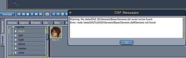

warning file /data/daz 3d/genesis/base/genesis.dsf could not be found error nodo -C8.5P
i checked, the file is in the data folder.
how can i help CA find the file?
is there a registry key? i can't find an .ini file.
i submitted a support ticket, but i impatiently want to start rendering CA, :lol:

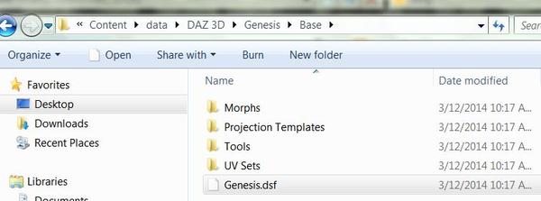

    Where is that folder called Figures contained in?
    You have a folder on it's own for Aiko 5, it has an icon, and I am assuming that it is Aiko 5.DUF. This file MUST be in the same DAZ Library as Genesis which is why I am asking where the Figures folder is located?
    edited March 2014
    it's under my ds content library. i didn't touch the data folder, everything in data folder is default.
    i read somewhere carrara only wants .duf files. but, i just re d/l the genesis starter essentials this morning, it's still a genesis.dsf file.
    755 x 281 - 42K
    Post edited by Mistara on
    DUF is the new DS file format for Scenes and other things, DSF files are still used in the data folder, so that is not the problem.
    Can you please post a screenshot of your DS Content folder, showing where the Figures and data folders are located? I have 'Aiko 5.DUF' in my folder in Carrara, and it is contained in My DAZ 3D Library\People\Genesis\Characters. When I load Aiko 5.duf in carrara, it works perfectly.

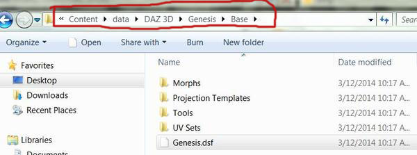

    Misty, according to the screenshot that you posted earlier, your data folder is NOT in the My DAZ 3D Library folder, it is in a folder called Content. That is why I wanted you to post a screenshot of your library folder. You should NOT have a folder called Content inside your My DAZ 3D library folder.
    If you have My DAZ 3D Library listed as a Carrara library, then Carrara will be looking inside that folder folder for the data folder, and it wont be found, because it is inside another folder called Content. Remove My DAZ 3D Library from the list, and add the path to the Content folder, and then it should work.
    Because you have named the library folder as 'My DAZ 3D Library' Carrara assumes that the 'data' folder is in that folder as well, and it isn't.
    Right.
    The names of the actual main folder doesn't matter to Carrara, but the exact structure of what lies within, does.

  • fixmypcmikefixmypcmike Posts: 19,719
    Both DS and Carrara need the Data and Runtime folders to be directly underneath the content folder. What are your content folders in DS?
