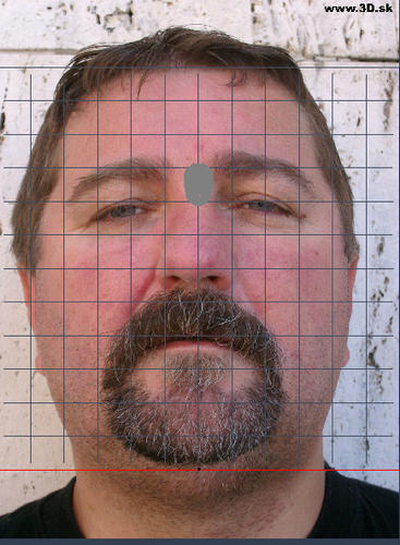

    Hi again,
    well, I tried Faceshop but I did not get any satisfactory result.
    Can anybody help me with the tutorial (see link in one of my posts above)?
    I just can't make the photo match the 3D head (see the attachement: this is where I am blocked).
    Thank you in advance.

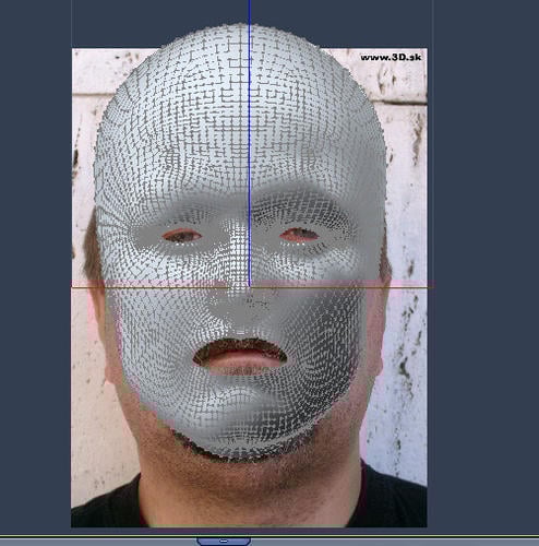

  • RoygeeRoygee Posts: 2,247
    It worked for me by following the tut exactly - except for the initial preparation, as I wrote in an earlier post. My ref pic also started out huge. Mine doesn't exactly match because the pic isn't a perfect head-on shot, but was the best I could find quickly.
    So glad you found this - opinions expressed in earlier posts was that it was not possible to size the background pic to match a model :)

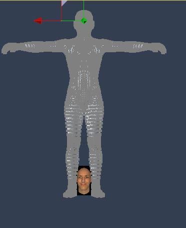

  • a.christie588a.christie588 Posts: 0
    Can you tell me how you managed to give the photo the same size as the 3d head.
    I keep repeating the process but I don't get the part about the grid.
    I set it to different numbers, the size and number of squares change but the picture stays the same.
    708 x 777 - 202K

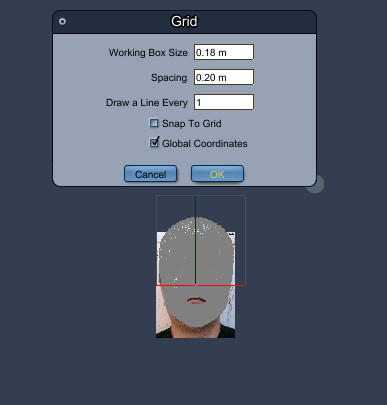

    I had to go through a few iterations of re-sizing the grid and aligning the working box to get the sizes matched - finally got it at .18m. This will vary, depending on the size of the reference pic.

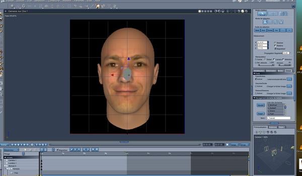

    No way.
    I must be stupid but I can't do it. And yet, when I follow tutos, I usually succeed. I wish it were a video, I would probably get it.
    372 x 454 - 19K

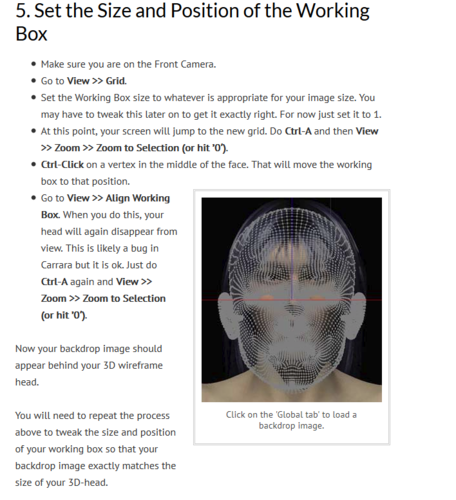

    Don't give up so easily!
    From what I can see, you are one click away from making it work - once you have the working box sized correctly, which it appears to be, you Ctrl- click on a vertex in the centre of the face, select "align working box" and the next click in an empty space in the viewport will jump the working box to the face.
    Have another shot at it!
