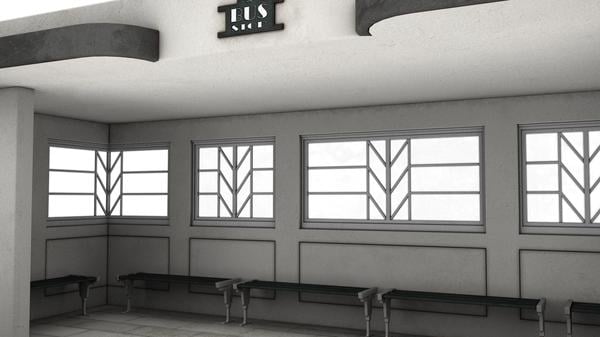

    Huh! I find this interesting; I usually render at SR of 0.4 while putting an image together until the final render and then 0.1 for the 'real thing'. It mainly affects the noise in dark or shaded areas.
    Here's the difference between 0.1 and 0.4 in a simple bus stop render. In the reasonably lit areas, there's some difference, but I'll admit it's not enough to note. In the darker areas, especially under the seats though, it's very significant.
    I can imagine that renders that don't have dark areas, or that make heavy use of backgrounds or DoF would probably find the SR less relevant, though.

    Interesting; I was using an Advanced Ambient Light. The images are darker than yours, which may be why the 'shmootz' shows up more, especially in that back corner and under the seats. I suppose other variables include the samples the light is set for (both my Ambient and your UE2)...
    That said, with those images and that lighting, it definitely doesn't seem to matter what SR you set it to, they're very similar. I guess I just need to spend more time understanding lighting in DS, because it's always mattered for the images I've put together. :-/

    Right, I was just editing my post to include this:
    Just keeping track for my own use, bumping from 0.75 to 0.4 took an image from 1m10 to 1m41. (AAL SS32 AOSR4, HM:Prim). Fwiw, in the same image, turning off HD details took it from 4m exactly to 1m10.
    Using UE2 w/ Shading Rate of 4 and Render Settings SR of 0.4, image takes 1m16 to render, comparable shmootz. Render Settings SR of 0.75, it takes 1m2.
    I see.
    Okay, so the argument being made is that the Render Settings SR can be higher (0.5 or even 0.75) if the lighting you're using has a Shading Rate of 4 (or lower), because the lighting's Shading Rate gives the same quality level without as much render time impact as lowering the Render Settings value. You can de-speckle (de-shmootz) using either setting, but you get more 'bang' for your cycles from changing the one in the light.
    Okay, that makes sense. If I've got that right.
    -- Morgan
