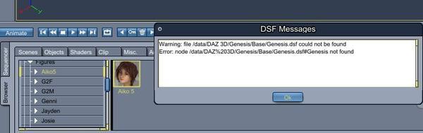

is there an ini file for cararra where i could tell it to use one monitor? i have to turn off my second monitor or it's unuseable, had to kill it in task manager. (win7home64)
it won't load Aiko 5 or M6. gives me an error message about .dsf. help!!

    Where are you loading Aiko 5 from?
    Aiko 5 is a morph of Genesis, and as such, it needs access to the Genesis base in the data folder in the main install. You need to point Carrara to your DAZ Studio content folder so that you can load Genesis figures I think.

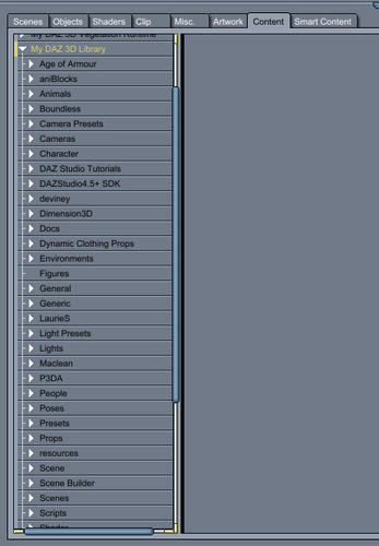

    the auto-detect didn't find my ds mylibrary.
    i did an add folder and in the list selected 'content', the other option was poser. tried it first as add runtime, but it didn't work.
    i don't know what to do next? help!
    does carrara need to see a 'content' folder name? i followed the 'new' ds format by putting everything under 'mylibrary' folder name.
    it seems to be reading the folder, everything is showing up in the browse, content,
    thanks :)

    I have 'My DAZ 3D Library' listed as a content folder inside Carrara, and it works fine.
    I can load Genesis or Genesis 2 with no problems.

    do you have your folders setup \content\data or \mylibrary\data ?

    renaming mylibrary to content should be able to test without breaking DS.
    Post edited by Mistara on
    There is no need to rename anything.
    Simply add your 'My Library' folder to Carrara, and all of the folders underneath that should be available to Carrara. Are you using Carrara 8.5, the latest version?

  • DustRiderDustRider Posts: 2,911
    A5 is working fine for me as well, here is my folder structure:
    C:\Users\Public\Documents\My DAZ 3D Library\People\Genesis\Characters\Aiko5.duf
    The error message you are getting indicates you are trying to open an "older" .dsf version of A5, rather than the newer .duf version. Have you upgraded A5? if so, do you possibly have two content folders for DS (one created for DS 4, and one created for DS 4.5+).
    Carrara 8.5 needs .duf files, and will typically error out with a message like you are getting if you try to open .dsf files.
    Hope this helps.

    well :bug: i ran the carrara 8 native installer. didn't fix my problem. i drilled down to the data folder, there is a genesis.dsf in there.
    i'll try re d/l genesis essentials
