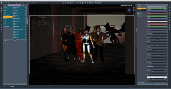

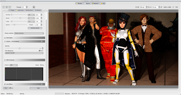

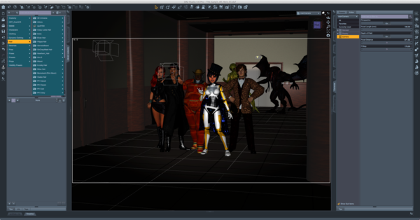

Hi there all. I’ve just started playing around with the amazing Reality and Luxus plugins for Daz Studio (each one exposes different options of the underlying rendering engine, and I am trying to decide which I like better). However, one thing is clear . . . I do not know what I am doing in terms of lighting and materials in order to get good results out of LuxRender. The results I get right now are so-so, not great, but okay . . . but nowhere near as nice as 3Delight. I understand that Lux is fundamentally different in that it is an unbiased physical renderer — i.e., it mimics the way that light really behaves. Thus, since I’m not getting good results, it would seem my knowledge in this area is somewhat lacking. I was wondering — based on the included screenshots, can anyone tell me what exactly I’m doing wrong? My results are looking WAY too cartoony for my liking, and I’d like to get as close to “photoreal” as I can. Thanks for any help ahead of time!

    It doesn't look too bad to me to be honest. If you want photorealism, you'll have to work hard on getting the materials just right. I've been working with Luxrender for over a year and realism still manages to elude me. Check the Luxus and Reality threads for tips on working the materials the way you want them.
    Ah, you've lit it for 3Delight, haven't you? I'm afraid you'll have to pretty much re-learn how to light a scene, converted LuxRender lighting gives results ranging from so-so to amazingly bad and amazingly slow. For indoor scenes like you have there, mesh lights are the key. You can select the actual light materials (this is helped a lot if the light surfaces are separate materials) and define them as LuxRender lights. It does need a lot of fiddling with the settings, and the renders will take a lot longer.
    As mentioned, materials are also important. The auto-conversion in Reality and Luxus usually work pretty well, but some things will need manual conversion and tweaking.
