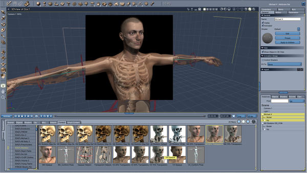

  • 3DAGE3DAGE Posts: 3,321
    In the "Content" browser,. inside your "runtime" folder, you should have "Poses" to make the Skeleton handle invisible or opaque.
    there should also be poses to adjust the M4 or V4 Figure skin to 50% 75% transparency.
    pic to help.
