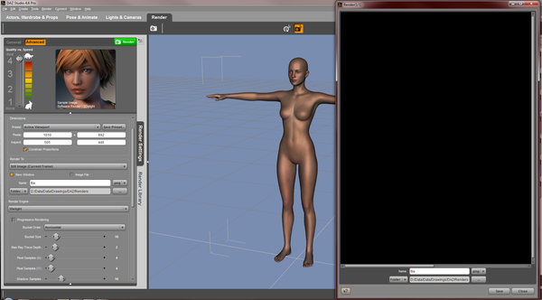

Hello! I'm new to DAZ3d and I'm having trouble with rendering in 3delight.
The other options work fine for me.
I'm sure someone has had this problem before, but after hours of searching, I can't find anything!
When I render with 3delight, it just shows up black. Just a plain black image.
> I have not messed with ANY settings, and haven't manually installed anything, or messed with it in anyway.
> I am not using lights, because I know that is potentially a problem that can make a black image.
> The attachment shows what I'm talking about.
Thanks anyone who can help. Sorry if the solution is silly and stupid >.>
1905 x 1053 - 337K

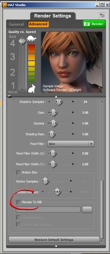

    Can you check in your Render Settings if Render to RIB is accidentally turned on?
    You have to scroll down.
    It should be off.
    (We'll explain later)

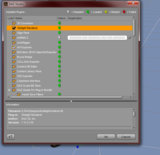

    Go to Help > About Plugins and post a screenshot of the top part of the list (3Delight should be the first item on the list).
  • sgtkneecapzsgtkneecapz Posts: 0
    Is this what you were asking for mjc1016?
    666 x 648 - 66K
    Yep...
    And according to that, it's working...or at least loading properly.
