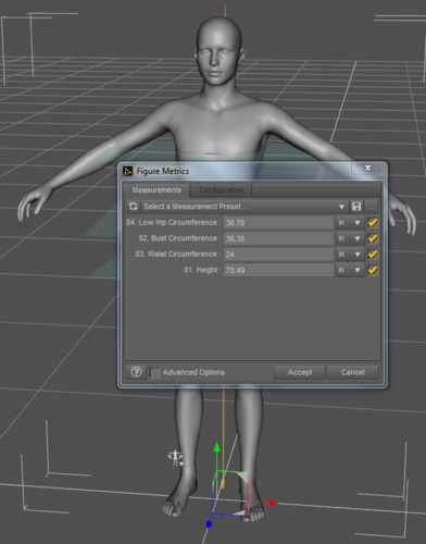

    Here are my steps to use the system...
    Load figure and morph to shape Male or Female, here it's just V4
    Then apply the Pose to the figure followed with the Wearables Metrics I will use..
    This keeps the figure selected which is needed.. then I run the Script
    The Script for me opens populated but locked to defaults
    I can then check the loaded nodes with a tick and edit.
    I have not tried it on none Genesis figures at this time.. I'm no help there.
    870 x 914 - 187K
