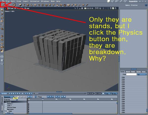

If I use a physical force in Cublc Swarm, then if I have not applied any physical force in Cubic Swarm,
but the Cubic Swarm to the breakdown. Why?
Please, click the bottom image(GIF animation).

    Probably because the cubes all have a "distance" sensitivity setting. As they touch they are jittering, like resistive magnets - they want to fly apart.
    Try adjusting your settings (including friction and air resistance), and use Bullet physics, it is more stable.

    Try to put the collision distance at 0 or 1, no more...
  • Dave_5690Dave_5690 Posts: 19
    If the blocks are touching at the beginning in bullet physics, they'll explode. If you can't put a little distance between the objects, switch to the standard physics solver. It will leave them intact if they're touching at the start.
  • edited March 2014
    Very thanks, gentleman. I solved the problem.
