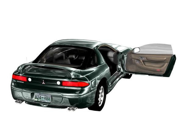

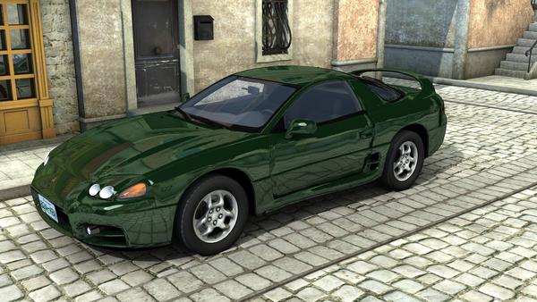

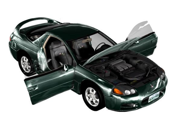

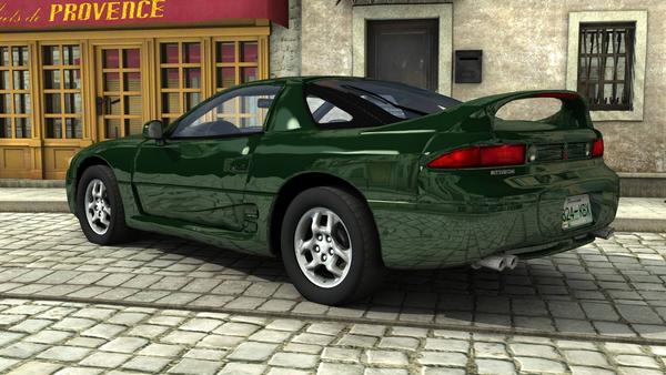

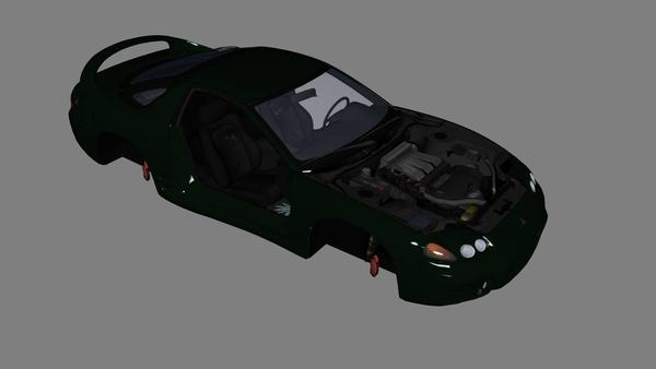

I have been building this 3D model in 3ds for the last 3 months, because I needed a class project for the end of this semester . So I made a exact Model of my car a 1998 3000 GT VR4.
I have pains-takely measured everything for scale, built this model in pieces as you would have a real car and even created my own UV & textures most of which are real photos I used from taking them with a pentex x40 of my car
I have it almost completely done and it works really great in 3ds so I have no issues with it for class.
But here is my problem, I would like to use this model as a Daz Studio model and maybe, be able to market it if it is good enough.
I have tried 3 ways to sideways to get Daz Studio to accept my rigging
I have even tried recreating the rigging in Daz Studio with the Imported Obj ansd creating new bones., accept i am having a wicked hard time trying to get the rigging to work for the wheels, Doors, Hood and Hatch-back. I can import all my Martial zones into Daz and I can import the Obj as a wavefront Obj into the Figure set up tool, but all I can get is my Surface settings and not my 3ds Rigging settings. I have been going over all the help files http://docs.daz3d.com/doku.php/?do=googlecustomsearch&id=Rigging+a+model+
That daz has on rigging and that just seems to confuse me more..lol. And sadly seeming daz is not part of my Teachers expertise so he is no help either..lol
Can someone plezzzzzeee! tell me what I am doing wrong. or have some good help info for rigging in daz with 3ds models?
if I can get this to come out good enough I would like have it be my first items I can market.
I rendered these in Daz Studio with UE2 light , so you can see my desire to get this model rigging in daz to work. one of my real car one of my model.
1440 x 1080 - 247K
1920 x 1080 - 297K
1440 x 1080 - 303K
1920 x 1080 - 318K
Post edited by Ivy on

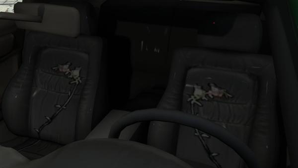

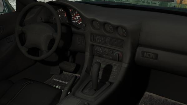

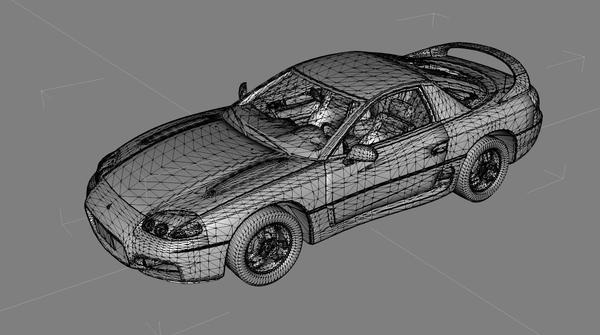

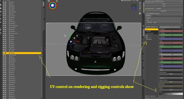

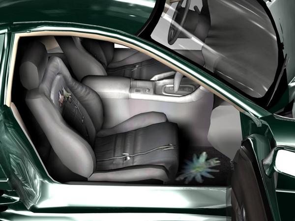

    a couple more pictures, best viewed full size i created this with Sub-D and SSS Maps
    1920 x 1080 - 59K
    1440 x 1080 - 95K
    1920 x 1080 - 675K
    1920 x 1080 - 314K
    1440 x 1080 - 113K

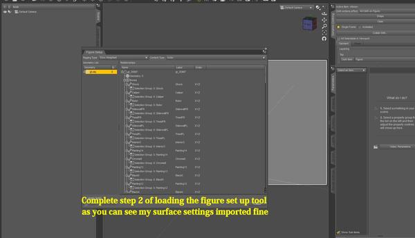

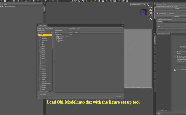

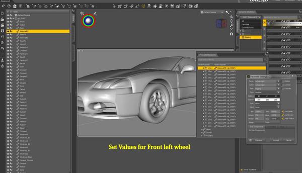

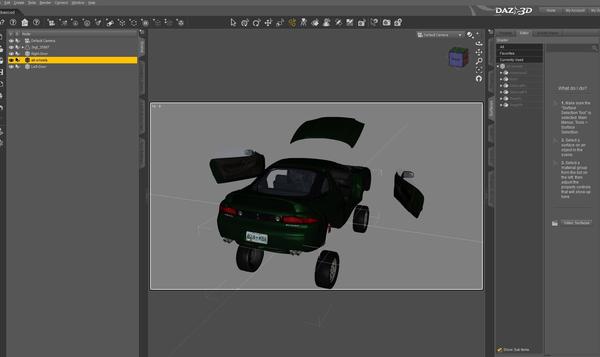

    Okay I was playing trying to get my rigging imported into Daz. and I thought i post some snip-its to help show what is happening.
    The first 5 steps i loaded my Models into daz with the figure set up tool and this will show the steps i took to get my models into daz. and maybe some can see what I missed. because right now the rigging that works in 3ds but not in daz i can find my rig settings under the edit tab but the model rig still does not work correctly so I'm hoping posting these snip-its will help

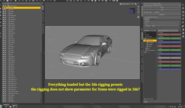

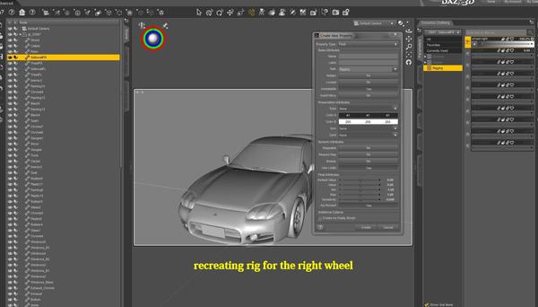

  • IvyIvy Posts: 7,165
    more snip-its of rigging ..what am am i doing wrong?

    Two questions. Firstly, where are your bones located and secondly, have you assigned weight maps to the areas affected by those bones? Since the objects being moved are rigid you'll want to select the whole wheel and flood-fill it with the weight map tools so that there's no distortion. Repeat the process for every wheel and it should work fine.

    I think I showed that the 3ds weight maps transferred over okay with the transfer wizard tool just the rigging values didn't transfer over so
    So maybe I think now that something got lost in the translation in the transfer wizard.
    The wieght maps transferred but the rigging was lost. somehow ..
    like I said I made this car to come apart. the rotors and shocks hood doors all move.
    The front wheels move on 3 axes independently and the rear wheels rotate on one axes and move together for one controls
    pretty much if it has a surface it has a bone for it to move for be controlled somehow..lol all accept the gauges and shifter

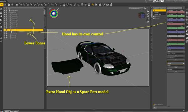

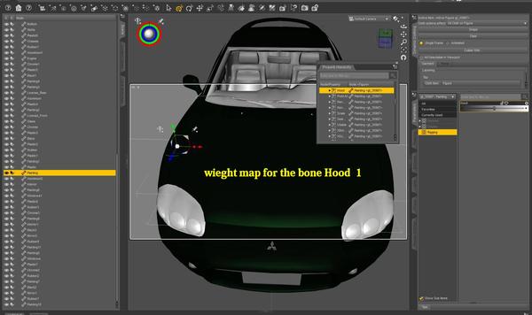

    Okay after some time of reading all the documents I found on rigging and wieght mapping
    I was finely able to rig the Hood of the car.
    But now I have to find how to fix the texture not separating during the actuation of the Control. Any Ideas how to fix it?
    1887 x 1125 - 193K
    edited March 2014
    In all likelihood you've added weight to vertices not part of the hood, or not enough. What you're seeing is the result of stretching a polygon as you move some of the vertices away from its neighbours. I've heard there's an issue with Daz occasionally welding vertices as well, so it's possible that may be occurring here.
    Is there away to fix it?

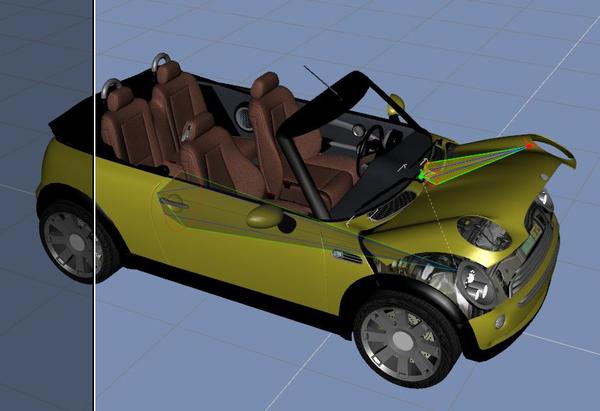

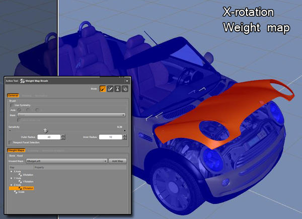

    If it's welded vertices, I'm not sure it can be done without importing it with the hood popped up slightly. However, if it's simply a weight map issue then it's much easier to fix. Here's a quick example of a car I exported and imported back into Daz Studio as a base OBJ (no bones). I've only worked on the hood in this example.
    Here, I've selected all of the polygons in the hood and set them to a full 100% weight map. What this means is that all of the vertices in that area will be fully affected by the bones movement. This is much MUCH easier to do if you've already assigned material zones to the hood separately to the main figure as you can select polygons by region. The bone itself sits slightly higher than the hood due to the curvature so that there's no unnecessary clipping into the body of the car.
    Here's how the weight map looks, along with the bone layout for this example.
    843 x 577 - 62K
    743 x 537 - 246K
  • JaderailJaderail Posts: 0
    edited March 2014
    Yes that does look like the welded verts issue. I think the only correction is to save out the HOOD as a OBJ and use it. The welding is default in the original object file I think. Might check it in a good text editor.
    Note: I'm not as up on this as those in the CAR and Bike thread in Art Studio. They do this stuff all day.
    EDIT to add, the OLD Poser morphs had a way around that in DS3 but DS4.5+ broke it.

  • kitakoredazkitakoredaz Posts: 3,526
    I usually work only blender,, so that I can not advice about 3ds max ^^;
    but when I make rigged prop,
    I must keep each part which need rotation, as separate obj.
    because rotation parts vertices should be not merged , I think,,
    (to work easy I made them as one group in blender)
    after all I select all parts then export as one obj - obj groups, and import the obj file in daz studio,
    Individual obj parts are gatherd as one obj, but not merge vertices.
    and each individual parts are auto assigned as Face group in daz studio.
    (The import ,export setting often change how group are made in daz studio ,
    It may change which 3d tool you used,, so that 3ds max user can only advice about
    setting I think ^^;)
    Then,, if you use "fill weight by selection sets"
    ds must color each goruped vertices with full 100% for each rotation .
    I believe, we need not adjust weight color.
    And If you hope to offer (I hope you will sell products for ds user ^^,)
    product for daz studio user, I beleive, you may better make it as triax weight figrue too.
    of course I understand, rigged car not need triax weight, you can make your car as same as poser type,
    general weight rig.
    but only tryax weight figure can be saved as DSON at current. the file type really much for current version ds.
    it offer us many flexbility and easy use them for current ds version.
    If I serch items in daz shop, I must check which the item is offered as cr2, pp2, or duf (and dsf) about scean props, rigged car too.
    I know there are users who do not care much, so that It is only my request ^^.
  • WendyLuvsCatzWendyLuvsCatz Posts: 41,821
    Ivy, just curious, is it triagulated in Max?
  • Richard HaseltineRichard Haseltine Posts: 112,003
    If you separate the bonnet in the modeller it should be OK in DS - as long as the modeller isn't merging coincident vertices on export to OBJ. DS doesn't merge, but nor does it split in DS4 the way Poser and DS3 did (they break models up into their consituent groups, then weld them back together as specified in the CR2, which is why several items have needed updates).
    general weight rig.

    well I went back to 3ds and saved a different copy of the Obj I took most of the little things i had rigged and shut them off and hid them so I can start with a few rig settings to see if that helps , the top few pic show you how it works in 3DS, But when i transfer it over it , Does it not transfer the 3DS rigging locations automatically because if it don;t man it be a great feature if it did..lol
    But anyway as you can see I have fewer bones to deal with now in the last picture ,
    1903 x 1134 - 161K
    1024 x 768 - 82K
    1024 x 768 - 54K
    1024 x 768 - 68K

    Okay after working on this most of the afternoons and still could not get the poly to unweild
    I decided to take a different route and build each rigged part as a obj and and inport them one at a time..
    so now my question is what would be the best way to attack and rig each of this parts? Conventional weight mapping won't work will it?
    or should i parent it and use a pivot point?
    or is there still a better way to do it in Daz?
    As you can see each part has its own obj in the renders below.
    what next? ,,lol
    1920 x 1080 - 52K
    1859 x 1105 - 114K
    1920 x 1080 - 64K
    1920 x 1080 - 71K
    That's probably the easiest way.
