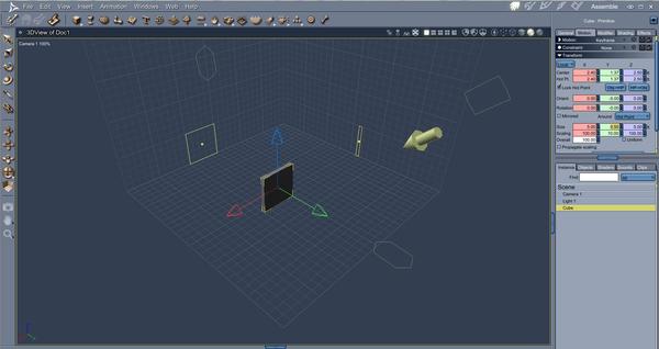

    If all you want is some 0.5 ft. thick slabs in Carrara it's very easy.
    One way is to Insert a cube primitive into the scene, then change the Y or Z size value to 0.5 (the default units in Carrara are ft., but can be changed in the preferences), and you have a .5 ft thick slab. Copy and paste the slab to make more slabs.
    There is another way to do it if you want a slab that you can use to create models with in the model room (i.e.a house). Insert a plane primitive, then open it in the model room, convert it to the" vertex modeler", select your new vertex object (the plane), then select add thickness from the model menu, put 0.5 in for the value, and you now have a 0.5 ft thick slab. Again, copy and paste to make more.
    The attached image shows the cube primitive as a slab.
    1530 x 810 - 148K
    Post edited by DustRider on
