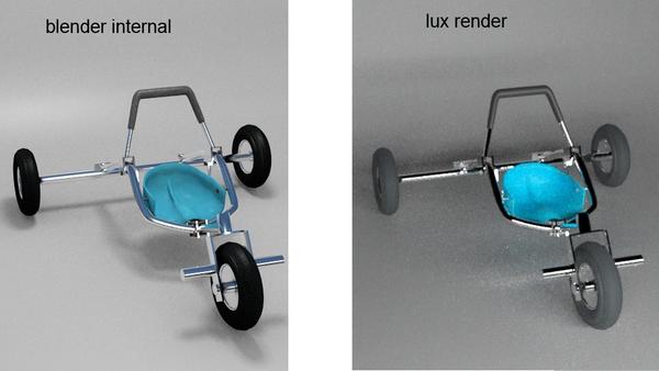

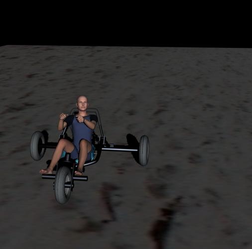

    Hello friends,
    I was able to import and use this http://www.sharecg.com/v/27568/material-and-shader/Ultimate-Shader-Pack-for-DAZ-Studio?interstitial_displayed=Yes and apply it to areas of the model.
    Thank you so much for these!!
    Renders attached:
    I need help on improving my Daz studio render if you would be kind enough
