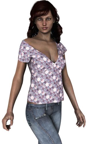

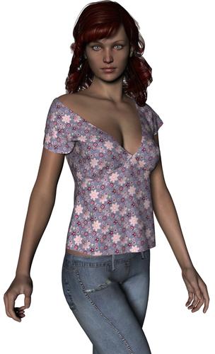

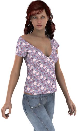

I've always been amazed at people who routinely post super photorealistic renders, and most of the time wind up getting depressed about it as I read about using plug ins, complex lighting, different rendering engines, tricky tweaks on materials, etc, etc, etc.
Then, tonight, I stumbled across a method that gives me some really good results in three simple steps: Two renders in DAZ, and one simple post-process in Photoshop or Photoshop elements.
I know a lot of folks here are always looking for ways to improve their renders, so I thought I'd share. So, get your model all staged and follow along.
Step zero, of course, is to set up your lighting. You will need at least two lights: An environment light that does occlusion such as Uberenvironment or the Age of Armour Advanced Ambient light. I prefer advanced ambient because you can use its flag feature to lower sample rates on hair so that your render doesn't slow to a crawl on transmapped hair.
The second light you'll need is a key light to cast shadows. In my examples, I actually used two shadow lights: a key light and a back light.
Step one: Set your ambient light to 100%, occlusion with soft shadows, turn off all other lights, and render.
Step two: turn off your ambient light, and turn on your shadow lights. In my example, my key light was a distant light with raytraced shadows set at 25%, white at 90% intensity. The backlight was a white spotlight at 100% intensity, with raytraced shadows at 0% softness. Render.
Step three: Open both images in either Photoshop or Photoshop Elements. Copy and paste your shadow image as a new layer on your ambient image. Convert the shadow image to black and white (Enhance > Convert to Black and White). Set the layer to Hard Light and the opacity to between 65 and 70 percent.
That's it! As you can see the results are very impressive. If you want, you can play around with the hard light opacity and the light levels of the shadow image until you get the exact look you like.
Enjoy.

    Thanks, but which one is the final one? It's early here and I'm a bit too slow to notice the most subtle changes. I'd love a way to speed up rendering of hairs Neftis makes. I always use UberEnvironment, because I'm lazy, but those hairs - especially curly ones - are so long to render...

    The images are first to last: ambient occlusion, then raytraced lights, then the mix. You can see the effect better if you click the thumbnails.
