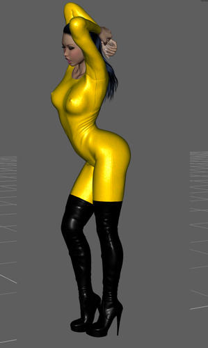

    I gave up on that outfit and tried the trusty V4 Body suit.
    This is what it does (See attached)
    This is with smooth modifier applied and I hid all the other body parts because they all poke through.
    JD
    1414 x 2000 - 368K

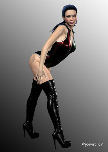

    See my example, where I have used a push modifier on both a body suit and boots, and then applied a smooth modifier on the boots to deal with poke through from the body suit.
    Thanks!
    JD
