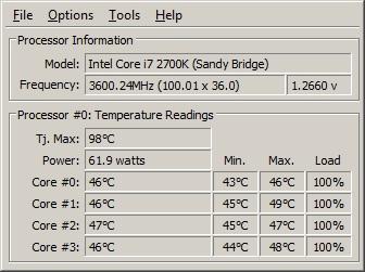

I would just like to know whether you think these high?
Edited to add the screenshot ... :roll:

    No...
    If they were in the upper 50s, then maybe a bit warm...the 60s would be hot. I've seen a number of games push the core temps to the upper 60s, even with massive cooling.
  • Dream CutterDream Cutter Posts: 1,224
    I concur with MJC, also the delta between min and max is rather insubstantial so the cpu heat sink is working great. Your CPU is what gets taxed most during renders as the GPU / Video graphics card is only under duress during scene setup with the DS GUI manipulations. Depending on factors, high dust & lint environments will require the PC case to be opened and get dusted out every 60-90 days. I recommend vac or canned air, and recheck all wire connections and test all fans are operating before reassemble. Keep AC power plug - plugged in and power supply switched off (not just front power bezel). Keeping ac cord in wall socket maintains grounding and helps protect against static. Note vacuum's generate static along the plastic suction tubes, especially in dry winters.

    Those temperatures are fine. Did you build your system yourself? If you bought it preassembled, they did a nice job, better than average. Rendering tends to be a good test of cooling actually, it is a very processor intensive task and parallels well (in other words it uses all of your processor cores efficiently.

    Kerya what software is that? I wouldn't mind getting it.

    AMD here...and mid 40s to low 50s.

    In the initial post that T junction max. is listed as 98C .
    The actual thermal trip is around 20C above that so you're good to go till about 120C :coolgrin:
    A machine that can't run at 100% for 24/7/365 without overheating has something wrong with it.:-S
    Every machine should be able to do that its part of the job description!
    edited March 2014
    46c when rendering? Some people have that when idling.

    The Tcase value for 2700k is 72.6c. Anything up to that is normal. You can go to 80-85c and the cpu will still be fine. Just don't let it get to around 100c+. i7s run hotter than most quadcores iirc.
    If you're using the stock cooler, change it (I use a Corsair H80 liquid cool on mine). Stock coolers are crap, especially if you plan to overclock (the K in your cpu designation means it's unlocked for overclocking) and do more than web surf and read email.

    Thanks for all the answers!

    It's running now since nearly one and a half years, but I just found that Core temp app
    and decided to ask whether these temperatures are ok as I couldn't find answers by searching the internet.
    Dream Cutter: yes, I am doing the canned air dusting every 2-3 months (not much dust in that room).
    Szark: it's a free app: http://www.alcpu.com/CoreTemp/

    To avoid confusion, the 2700K is not a 2x4 core (since that motherboard isn't a dual-cpu board). It's a quad core w/ hyperthreading, meaning 4 physical cores and 4 virtual.
