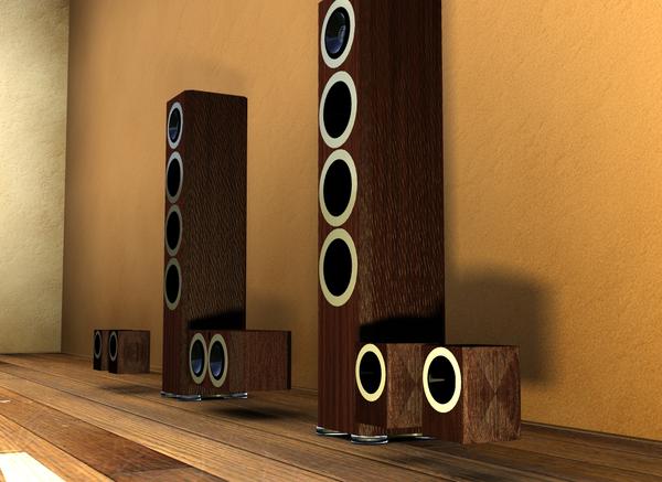

I am making a set of speakers and I am having problems with the sides of the shelf speaker, they have a slight curve and the texture is not mapping how I want it to.
can anybody help please?

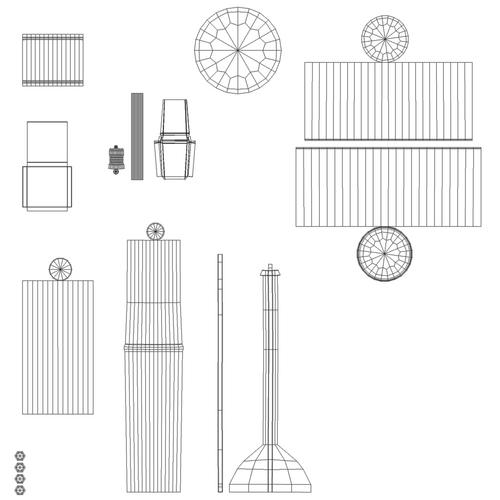

    Can you show an image of the UV map
  • Alpha01Alpha01 Posts: 160
    I am sorry, I don't understand.
    Is this the UV map ?
    816 x 688 - 149K
  • frank0314frank0314 Posts: 15,116
    No, this is what a UV map looks like. It seems that there are messed up UV's and its not carrying the texture properly.

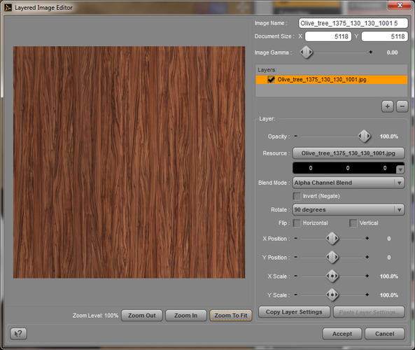

    I am making the models in Bryce and sending them to daz studio, then adding the textures through the layered image editor.
    I guess that's where I am going wrong then. Will I need to send it hexagon and create a UV map for it or can I do that in daz?

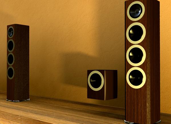

    ok I have done it :) I don't know how I have done it or why its done it, but its done it.
    I had to import the wood image into Bryce, add it as a texture material.
    Then I added it onto the shelf speaker surface.
    I then exported the shelf speaker as a .3ds file.
    I opened it in hexagon.
    Selected the sides mesh and sent that to daz studio.
    In daz I matched the material surface to the other sets of textures as the floor standing ones.
    And then the texture I originally was trying to paste on to it...
    Pasted on to it.
    Now my head hurts :)
