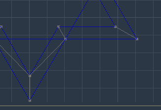

Hello.
I'm starting my modeling learning and doing my first prop. I'm using Carrara 8.5 pro.
But one thing is happening that I have no idea why or how to solve it. So please, some help. Would like to avoid create everything again.
As you can see in the image, there's a kind of surface that comes out of the star. But in hireframe it just doesn't exist, so it's not actually a polygon and so I don't know how to correct.
The more strange part is, when I saved the file, it wasn't there. Today I opened the file again to continue my work and it was simply there. When I select the image and move it disappears, and then it appears again while I'm working.
And if I export an obj and open in daz studio more of this appear, even that in carrara is just on one side.
I already accepted that probably will have to do this part again and then align it with the other parts again, but would really like to understand what's happening so it doesn't happen again.

  • DUDUDUDU Posts: 1,945
    I believe, according to your screen shot, that there is perhaps inconsistency in the extrusion of star and the graphics card does not follow… There is some time of the files which it is necessary to start again since the last good version.
  • MysticWingsMysticWings Posts: 226
    It was not an extrusion... but a boleean.
    But the logic is the same...
    In this case, really have to model all over again... or almost all. Have to start make things in different documents and keep them there until it's over I see... :(
    Thank you for your answer. At least now I can understand why this happen.
    Maybe instead of a boolean, which can cause issues with the geometry, you could use the empty polygon command under the Construct menu if you're trying to make a hole.

    You would need an inner shape to define the edges, otherwise the whole surface will be emptied.
    The other possibility is the spline modeler. It excels at this sort of thing.
    Insert a spline model.
    Change the view to front.
    Use the pen tool to make points in the desired shape. You can select the points individually to move them.
    When the shape is the way you want, drag the selector over the shape to select all the points and then copy and paste the shape.
    This next part may require a little trial and error. Select the scale tool and place the cursor over one of the lines (not a point), and shift-drag inward to scale the pasted shape smaller, or drag out to make the shape larger.
    Adjust the points on the pasted shape to fine tune the position if you want.
    Use the selector tool to drag-select both sets of shapes and then under the Arrange menu, combine as compound.
    You can select the end of the extrusion path (pink line) and drag it to lengthen or shorten the path.

  • tbwoqtbwoq Posts: 238
    edited March 2014
    I can reproduce exactly what the OP sees. When you scale the star shape in the modeler, it will show extra sides(polygons) that blink in and out of view. I'll do some more testing, but this appears to be a bug. I'm using C8.1 Pro 64-bit. Workarounds can be what EP or McGuiver show.
    update: The star shape I used was an N-Gon(a polygon with more than four sides). I saved the scene when the star shape looked OK. Then when I loaded the scene back, some extra sides(polygons) show up. Triangulating the star shape fixes the n-gon issue, but this is probably still a bug that needs reporting.

  • PGrePGre Posts: 95
    edited March 2014
    Forum ate my rather lengthy response and I don't have the energy to retype the whole thing. Here's the gist.
    Not a bug in Carrara but a problem with your geometry. Possibly introduced with the Boolean operation. Fixable. Entirely avoidable as you gain experience with the vertex modeler.
    Here's my method for creating this object.
    Draw Star Shape
    Add thickness
    select top face and use the Extract Along Edge tool to create inner star shape
    Select newly created inner star shape and use Dynamic Extrusion Tool (with CTRL or CMD held down) to push shape down
    Move camera to view bottom of shape
    Use the Link Vertex tool to connect the inner vertices of the bottom star shape.
    Use the Dynamic Extrusion tool to pull down center bottom shape.
