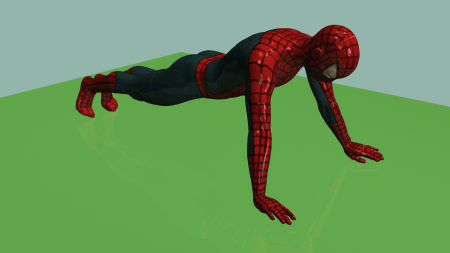

  • TjebTjeb Posts: 507
    Just to tease...
    450 x 253 - 555K

    Thanks for the tease tjeb :) That certainly is what I want to do.
    Well, here is the third way to do it, in case you give up:
    http://www.sharecg.com/v/53379/browse/21/DAZ-Studio/10-times-pushup-animated-pose
    Works on Genesis as well.
    The animated gif is obviously one cycle repeated endlessly. The whole sequence is 10 push-ups and come to stand.
    In case you're not familiar with shareCG: you need an (free) account to download.
