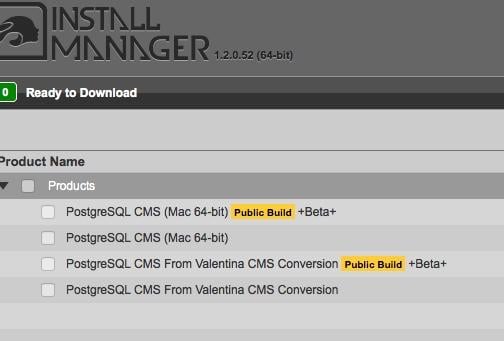

    Is this Valentina?  I find i get that on my mac after a crash; have you never been able to see your smart content?  I would check in DIM if the CMS is howing as downladed first (see attached).  Next check in Daz Studio's Content Manager to see if everything  is properly configured (see attached).  For all this to work, you have to have a working PostGreSQL CMS (the database manager), a proper content folder with a Data folder, runtime tec... and finally, there should be a Daz 3d folder in your Shared User account on your Mac that contains the Install Manager> Manifest Files and the files that tells Smart Content what is smart content... make sure that that isn't empty.

    PostgreSql CMs is in DIM... it should self configure when you install.  You must tell DIM where to install to and you must tell Daz Studio where the installations are.

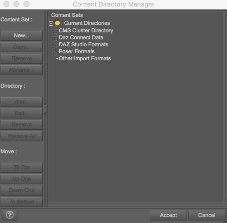

    You don't have a CMS Cluster Directory defined in Studio. Open DIM Settings on the Installation tab and look for Content Database Base and Content Database Port. In  Studio, open Preferences->CMS Settings and paste in the settings from DIM.

    Yep,  Daz Studio knows where things are by the mapping of content folders and runtimes on your hard disk.  Smart Content uses the mapping of the location, the metadata of the product,  and manifest files to decide "ah, this is Victoria 8 hair!" for example.  There are a million tutorials but here is a start... skip down to the content manager portion: http://docs.daz3d.com/doku.php/artzone/pub/software/dazcontentconfiguration

    I think DIM and CMS are working properly, but Studio can't see the database because the settings don't match, as you say. The DIM settings look greyed out, I don't think you can change them if CMS is running, but I would keep those and change the ones in Studio. You can start/stop CMS in DIM at the top next to the settings button (looks like a layer cake), and in Studio from the Content Library context menu.

    Did you actually install the PostgreSQL CMS (Mac 64-bit) onto your computer with DIM? Just having it downloaded is not enough. Close DIM and Studio and start them up again after installing PostgreSQL CMS. It should configure itself, and be ready to run the next time you start DIM or Studio. Then check the cluster and port settings for both.
  • FauvistFauvist Posts: 2,291
    DIM has PostgreSQL CMS (Mac 64-bit) listed as being something that is already installed.  So I clicked the Uninstaller.  Then I reinstalled it.  It fixed half the problems.  Now, when I use the search funcction in the Content Library panel of Studio, the installed product now shows up. I reimported all the metadata, and now the search in Smart Content works and the products show up.
