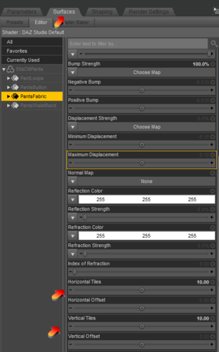

Set Tiles to 1 and 1 that's all I do.

Where do I find the tiles setting to set them. I looked for tile setting be I posted and can't find them.

If the texture you applied is tiling it will list in the Mat Zones in some area here is one I just loaded set to 10. Are you sure you applied the Texture to EACH material? Like once to Front an Once to Back ect...

Thanks, I had that set as 1 and 1, I thought you meant there was another place. The pattern is set correctly on the lines. There has to be something else going on here, I going to go back and look at the uv map.
