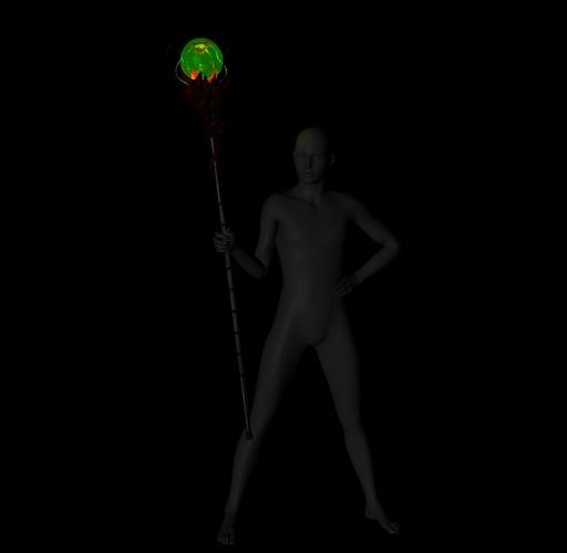

    Point lights In items work well if you set the items surface to have SOME transparency to it...
    Edit to add I turned the light very low so it did not fall on the figure, it could.
    967 x 945 - 50K
    Post edited by Jaderail on
    The Advanced Spotlight can be used like a point light and not cast shadows off the orb or whatever its inside of.

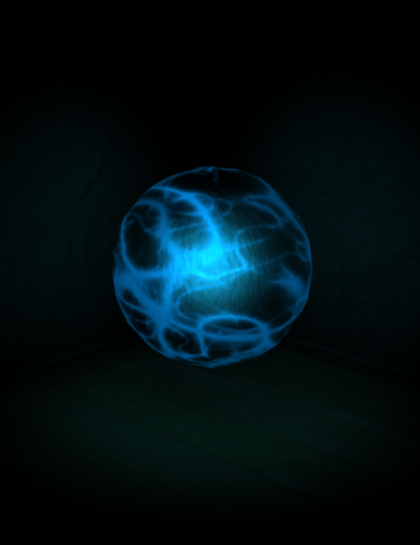

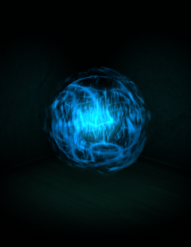

    I have a plasmaball freebie I created, but never released. It uses a sphere, geoshell, an adv ambient light, point light (point/geoshell can be turned off depending what look you want), and 3 versions of transmaps/displacement map I created in filter forge.
    IIRC from the AAL thread, you have that light. I could finally pack up the scene subset w/ my presets if wanted.
    /edit
    Packaged. http://www.sharecg.com/v/74972/view/21/DAZ-Studio/AAL-Plasmaball
