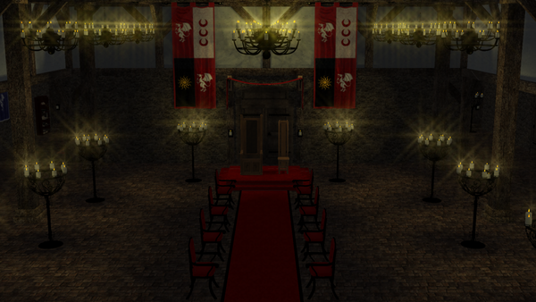

first 224 bulbs never mind the OTT cross-screen

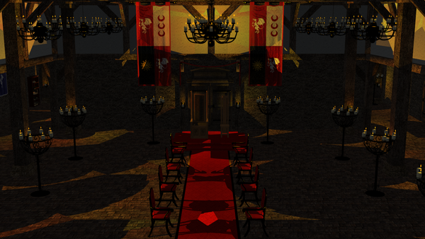

second flames as anything glows mesh
odd solid shadows
I made all the flames one mesh called flame
named anything glows reference object flame too
it casts light from each surface but has major shadow issues through the wrought iron candle stands etc

    In the screen shots, the AG light seems to be blocked. The AG light is based off of the mesh setup, so it can illuminate its own mesh or block its own lighting without the correct standoff/minimum distance settings.
    Since there is no representation or display of the standoff/minimum distances in the scene, it could take a while to get lighting to look right. You may even have to separate or detach a related mesh if objects are to close to the source of the AG light(etc.).
    My suggestion would be to avoid AG or EL(environment lights) lights in Carrara when possible. The 'Master Light' and regular lighting objects are usually much easier to setup and render faster in most cases to get similar lighting results.
  • Eric WinemillerEric Winemiller Posts: 84
    Anything Glows picks the closest point on the surface and calculates illumination from there. That means the shadow calculation is also done there. Using the a single mesh for all the flames is what causes the funny shadows. The floor is frequently blocked by the stand underneath the the closest point on the flame. There are no other light rays coming from the candles around the room. A mesh and Anything Glows light for each flame would give much better results.
    Having said all that, I agree with tbwoq and your first render shows, this scene works much better with bulbs. You don't really need Anything Glows.
    Glows works really good for odd shaped lights that are hard to emulate with the built in lights (e.g. neon letter signs), but these days you can often get as good or better results using global illumination. I built Anything Glows and Environmental Lighting before Carrara had GI.

    I was really just trying to figure out the effects of it and would just go with the bulbs.
