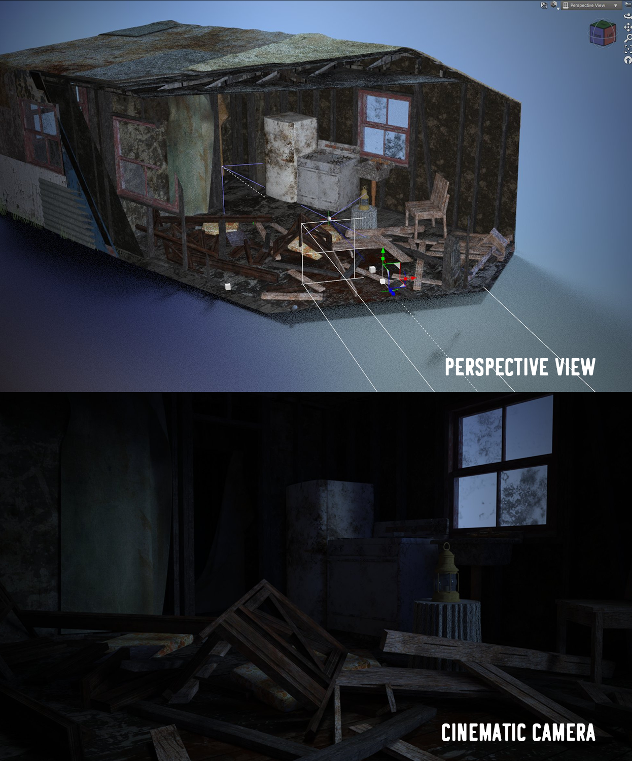

    One of the cool things is that if you can use Iray preview, it basically turns your interior prop into a stage. I've been using the x-ray camera to set placement of the section planes and then one of InaneGlory's cinematic cameras for the actual render.
    Comparison shot: top image shows section planes removing much of a prop's geometry. Bottom image shows the actual shot, which appears to be an enclosed room.
    You can also make more than one "cut"--in this render there's an x-ray camera in front and then another on the other side of the tube to shear off the end after the curve.

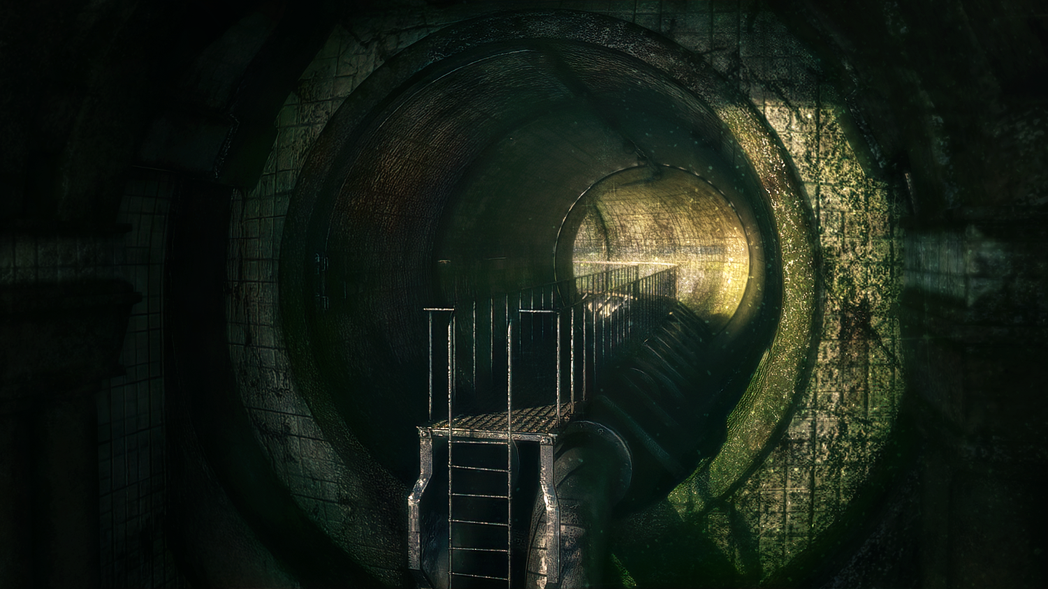

    Render of an industrial tunnel with light falling on the foreground and shafts of sunlight streaming through the distant end.
