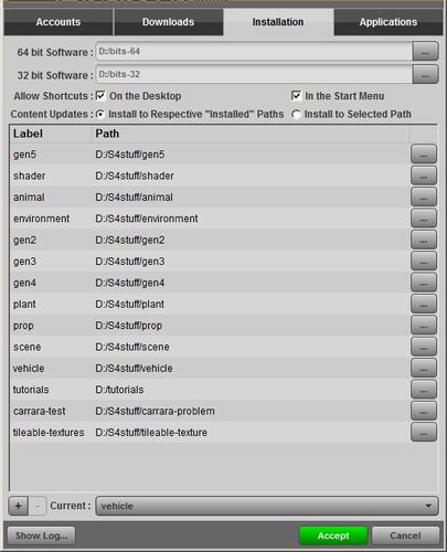

    I created the bits-32 and bits-64 folders myself- with DIM. If you click on the button with the three dots on it at the end of the path window DIM will fire up explorer so you can browse to the directory you want. Browse to your drive and then click on whatever icon or text allows the creation of a new folder and key in the name you want. (I'm on Win 7 and XP - no idea of what Win 8 looks like).
    You can use any names that make sense to you; it is just a name.

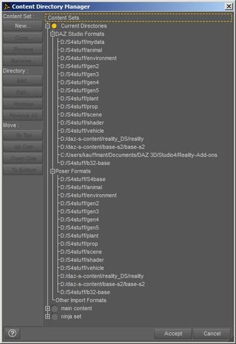

    I put in the 32 bit path because I've got Bryce and have used 32-bit studio to test a few things out at times. I did my CMS install prior to DIM; I'm not real sure where DIM will put it, but I'm fairly certain that it is 32-bit software, so that's what I would expect.
    Here is my DIM installation tab and my directory definitions in Studio. This is a bit of overkill, but again it is from pre-DIM layouts.

    Thank you so much for the break down of what you did, it sure is going to be invaluable. And thankyou so much for posting the screen shots I'll be hopefully working on it thru the next few days, Its going to be a great help to sort out my own folders.
