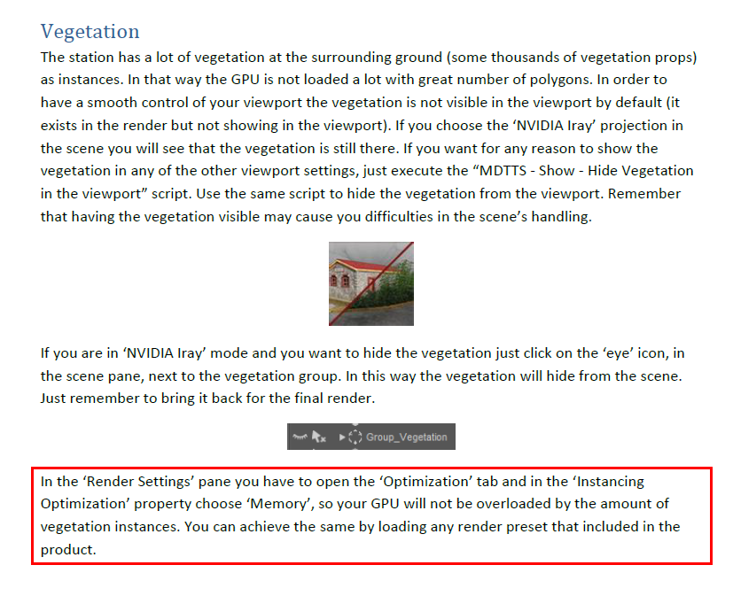

    Did you check that Instance Optimisation was set to Mmeory or Auto? I used the full load, including the vegetation group, for my test that rendered on a 6GB GTX card.
  • barbultbarbult Posts: 27,585
    Do you have Instancing Optimization set to Memory in Render Settings? That is critical for scenes with lots of instances. Auto usually works, too, but not Speed. (Remember that lesson from UltraScenery?)

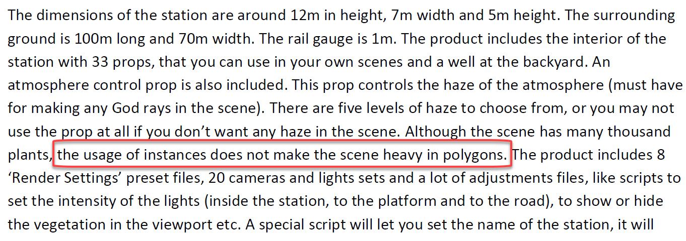

    As for your above comments, I colored in red and green, I totally agree with you ... I attach some screens from the Product's 'MDTTS Tips and Tricks pdf' (You can find them in the 'Scripts' folder of the product). These are pages 2 and 3 ....
    Anyway, thank you for your comments and I would like to hear your results about the 'Instancing Optimization' setting ...
