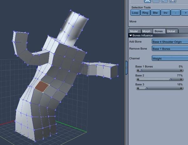

OK, so I modeled a simple card-soldier in the vertex modeler. It has a relatively flat rectangular torso. The polygons along the sides of the card near the middle are influenced by a lot of bones. This is not a deal breaker for posing, it is just tedious. i am just wondering out loud if attaching the limbs as groups with movement constraints (ball joint) could make this simpler.
In the attached screenshots, you will see that the side polygon I chose is influenced by 8 bones for the card soldier. A similar side polygon from the torso of a test object I made is influenced by only 3 bones. (edited to note that several of the bones are set to zero because I did that to get the pose I wanted).
So my question about nesting the rigging isn't about whether it is possible to get the pose I want, but instead it is about making it simpler and easier. And, my musings are forward looking - thinking about a complex machine that has both robotic and fluid parts (robotic levers and switches, but fluid hoses and belts)

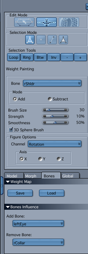

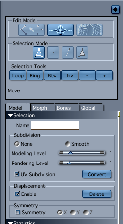

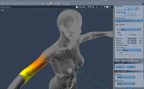

    Thanks for the thread. What I meant by "Weight" is that the Channel you have is labelled Weight. I don't get that. I get x, y z rotation or scaling or x,y,z bulge. I understand now that perhaps you get Weight if you ADD a bone where I was just messing about with shaping a Genesis figure. Any luck using 2D vs 3D sphere?
    :) Silene
    :) Silene
    Genesis figures are protected figures, the same with Poser and other DAZ figures such as V4, or M3, as such they are locked for most things, but you could weight paint them still, and save the weight map. I don't know if you can do this with Genesis or in C8.5.
    BTW, a major annoyance for me is that you could only save the weight maps for Poser rigged figures, and not internally rigged figures. The data was save within the scene file, so you could work around it, by saving different iterations of your scene, but it still kind of pisses me off.\
    My vertex and bone screen looks a bit different, but it is close enough.
    1140 x 704 - 271K
    237 x 683 - 51K
    112 x 74 - 5K
    255 x 463 - 40K

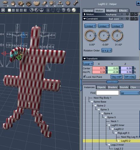

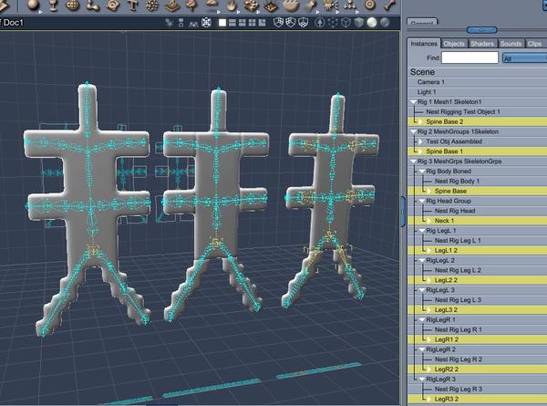

    Following EP's excellent tips, I was able to successfully nest a rigging that has both regular bones and ball constraints. To do my tests, I made three near identical meshes. Each had a rectangular core and multiple limbs.
    1) was a single mesh that was rigged with a single skeleton of bones
    2) was multiple meshes grouped together (core and limbs separate meshes) and the entire group with a single skeleton
    3) was multiple meshes, each individually boned with its own skeleton, then the meshes parented to a bone on the core
    Following EP's tips, using mesh #3, I chose the base bone of each limb and set motion constraints in the properties tray as if it were any other object. The result allows for bending of the core at the "waist" and the "elbows" of the limbs, but you can still use a robotic motion constraint where the limb attaches to the core.

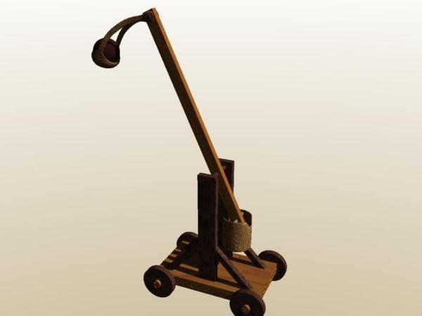

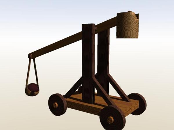

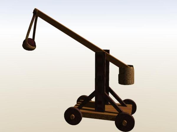

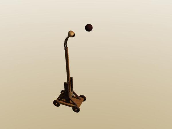

    Here is a simple application with a catapult. The beam and the counterweight rotates around on constraints. The sling is bone-rigged. The base bone is parented to the end of the beam (a cross peg). So the main beam rotates with no bending and the slingshot can bend. The effect is best seen in the third pic.
    This is pretty simple and doesn't really need the nested rigging, but it is a good tip to keep in mind for more complicated machinery.
    640 x 480 - 10K
    640 x 480 - 15K
    640 x 480 - 18K
    640 x 480 - 22K
