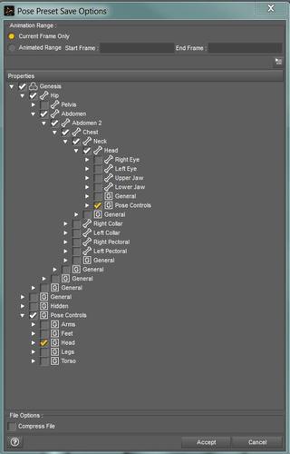

I have either forgotten how to save expressions or something has changed in the newest version of DS 4.6.
What I did is uncheck everything except Genesis/pose controls/head/expressions in "Pose Preset Save Options." This doesn't seem to work any more.
Edit: I got this to work but it seems more complicated than it used to be. I attached a screen shot. Is this the best/simplest way to do this?

    You could use the option menu, the button under the End frame box, to select Check Only>All Non-transforms, then deselect the root, pelvis and collar chains (click once to select all, once again to deselect) to leave just the head settings - though that will include the neck pose controls.

    Umm.. just expressions are a PITA. I do it your way not Richards.
