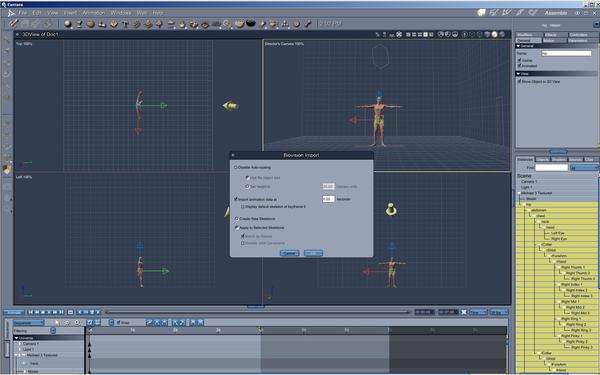

    ok, thanks for the replies, but take a look at the screenshot and you'll see two options for importing the bvh file, one says create new skeleton and the other says apply to selected, my problem is if I select create new skeleton, how do I attach the skeleton to the poser character? In the animation tab that option is greyed out. I selected the hips that didn't do any good I selected the whole hierarchy that didn't do any good, so how do I import to Carrara?
    1680 x 1050 - 412K
    1680 x 1050 - 401K
    1680 x 1050 - 396K
  • DUDUDUDU Posts: 1,945
    You should not create a new skeleton but apply to the selected skeleton (the hip).
