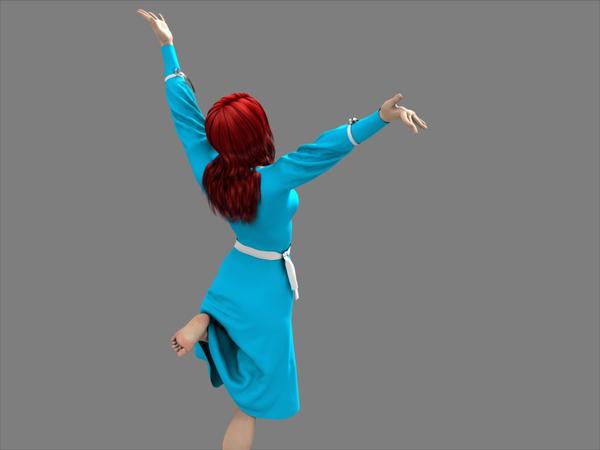

And for those of you who are interested I've finally released a new version of my Cloth deformer. I've posted a few of the results I achieved with this, here is one recent design that I've not finished with yet. The skirt, upper sleeves and ribbons are dynamic and the rest conforms.

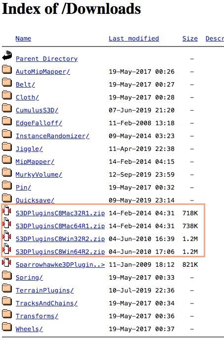

    There are 2 places where you can find Jeremy's plugins for Carrara 8.
    - 1) use this link ( https://web.archive.org/web/20210927200847/http://sparrowhawke3d.com/Downloads/ ) to goto the Index
    - 2) from his Internet Web Archive page goto Plugins -> The Laboratory to download beta versions. Some of them are Carrara 8 versions

    A more direct link to the Laboratory download folder ( https://web.archive.org/web/*/http://www.sparrowhawke3d.com/Laboratory/* ) Note the 'From' and 'To' dates. It has only captured files upto Dec 23 2010. That to me tells me that at best they are Carrara 7 or 8.0 plugins. Then again they are BETA's !   So be aware of that.

    Wow, @RuudL thank you a lot. I was aware of the Laboratory, but without your tip I would not have thought to go to the directory index (and I need the Windows versions)! A lot of the Carrara 8 versions are in those zip files, even though they do not match exactly with the plugin list page.
    https://web.archive.org/web/20221208130613/http://www.sparrowhawke3d.com/Sparrowhawke3DPlugins.html
    (I cannot access it at the moment. It's giving 503 Service Unavailable. Yesterday it did work, though)
    Anyway, it seems that from the zip these are missing:
    - Murky volume (that for some reason I already have, luckily), Cumulus, Quicksave, Terrain plugins, Instance randomizer
    while there are instead:
    - Capsule, Torus, Checker (I do not know where to find this in Carrara interface)
    that are not listed on the main plugins page

    Yes, the Murky Volume is not supposed to be in the Laboratory, but at the moment is missing
  • RuudLRuudL Posts: 227
    Capsule and Torus are primitives. You'll find them in the 'Insert' menu of the Carrara interface.
    Checker is a shader. It's in the menu of a shader channel. This is actually a SDK example.
