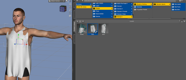

I've got dynamic clothing for Michael 4.
I can't apply it to Michael 4 as shown in the first screenshot.
I try to figure it out and I notice that in the scene tab, there is an X mark and invisible sign as shown in the second screenshot.
Please help what I should do to solve this problem. Thank you very much.

    it is applied, it will only FIT correct when you run a Dynamic Drape. Dynamic items do not POSE like conforming clothing, they must be draped using the Dynamic Plugin. The Lite version is included with DAZ Studio.
    It should Be Loaded to M4 selected also NOT to just the chest.

    Thank you Jaderail. This is a real headache for me for a week. The store never mention about dynamic drape. I think there must be something wrong with DAZ store policy. It's like they want to push us away from the store.
    Okay. I double click M4 to select the whole of it and double click the Shirt. Still the same. how can I activate Dynamic Plugin?

    All Dynamic items work with the Dynamic Plugin. It is covered in the user manual.
    Window>Panes (Tabs)>Dynamic and I strongly suggest reading the User Manual before you try to use it. The link is..

  • Richard HaseltineRichard Haseltine Posts: 112,049
