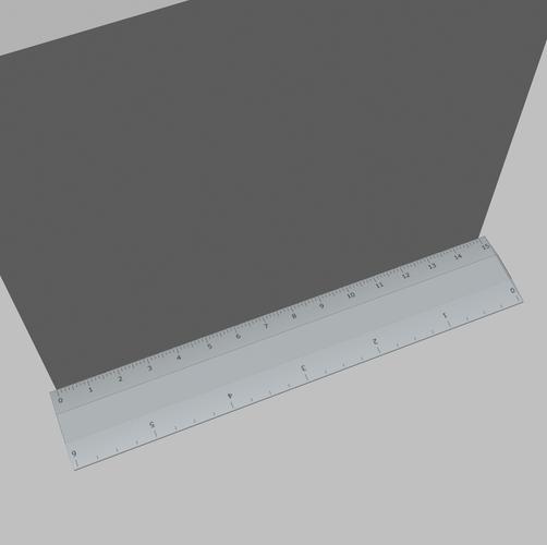

    Here's a render of a ruler I made some time ago. It's 15cm/6 inches beside a 15cm cube in DS. I simply modelled it to scale in 3d max, exported it and brought it into Daz studio.
    DS measurements are extremely precise. If I export a 99.99cm cube from max, it'll be 99,99cm in DS. I never bother importing figures for scale. They're too unreliable. If I want a wardrobe that's 100x200x50, I model it to that size. end of story.

    You loose nothing when scaling up or down between apps. To the program its all just 1's & 0's. Scale determines the size it appears on screen.
