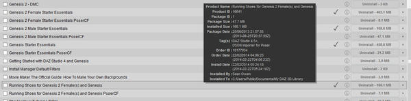

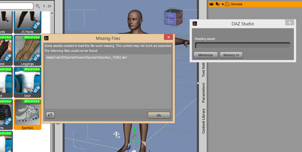

So far I have had very few problems with Daz Studio, mainly using the standard characters to model references. But...I needed to get some running shoes for a project and when installed (by the download manager) I keep getting the same message...See the image here abouts. I have looked through the download manager and looked for the list of files, which seems to say the missing file exists. And I have also re-installed the files.

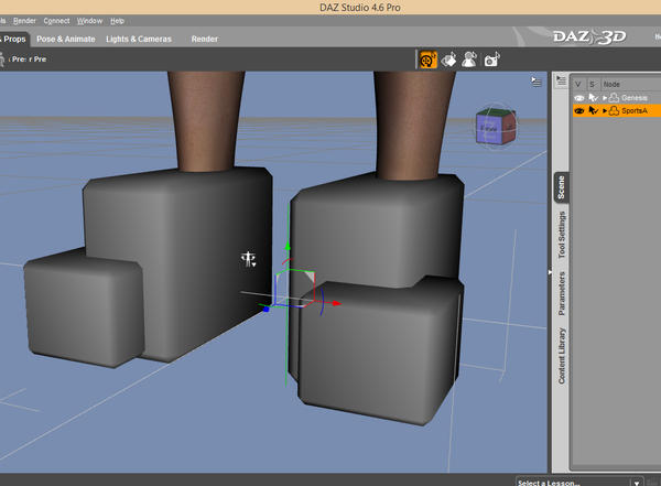

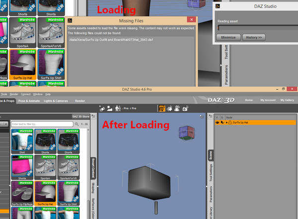

By the way other files loaded at the same time have also complained, a couple (Daz characters) have since fixed themselves, the shoes have not (the most important ones) and neither have things like the 'Surf's up Hat'.

Oh and btw, here is the installed files screen shot, if that helps...
The only thing I can suggest, is to post a screenshot of your Content Directory Manager, showing an expanded listing of your DAZ Studio Formats folders.
The path C:\Users\Public\Documents\My DAZ 3D Library MUST be listed as a DS Formats folder or DS will not be able to find the 'data' folder, and that is what usually causes this to happen.
