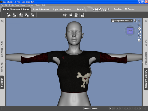

have you tried this way to properly fit Gen 4 clothing on Genesis?
I've tried this and it really does do away with the wrap shrink effect under the breasts .....seems to work great with any piece of sleeveless clothing.....the first screen grab is an example ....when I try this on something with sleeves there's problems usually around the arm pits and along the sleeves like the second example.......he says towards the end of the instructions this
"There may need to be some slight adjustments made to your clothes. Occasionally, you will need to transfer the rigging from your Genesis model and adjust it the shape. I’ll leave that up to you to determine."
how do I do that?

I meant for this screen grab to go first.

I'm surprised no one has left a comment....I was totally stoked when I came across this method after unsuccessfully trying several other ways to get away from the wrap shrink effect....still hoping that someone can tell me how to transfer the rigging from the Genesis model and adjust it to the shape .
That's an interesting article and something that I'll definitely try for a lot of the V4 clothing I have that could be used on Genesis.
Now, I'm not an expert on transferring rigging, but I'd suggest this as a starting point:
http://docs.daz3d.com/doku.php/public/software/dazstudio/4/userguide/creating_content/rigging/tutorials/transfer_utility/start
