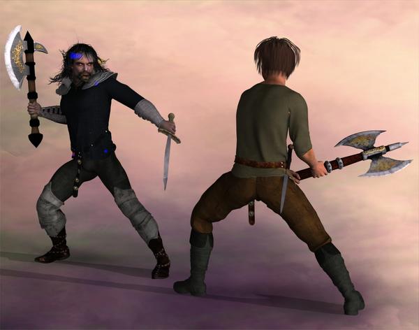

This topic came up once before, and the supposed explanation was the lights are not on raytace. However, I only ever use raytaced lights.
Size or complexity of a scene doesn't seem to carry relevance, either. My Kraken Station, rendered at 5000 pixels, and had no colored pixels. But this little 900 pixel, two figure draft has yet to render without them somewhere. The location and configuration is never the same twice, or in the same location or number of pixels.
Anyone have an idea as to how I remedy this?
Using DS4.6
Is there an easier rendering option?

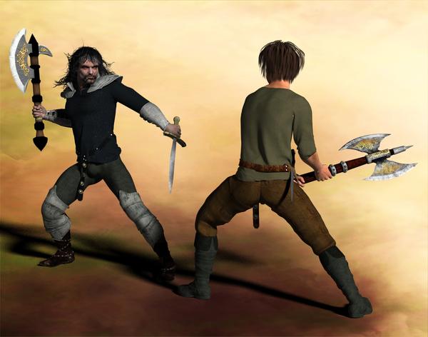

    OK ... Here are the three drafts of the scene, together for easy comparison.
    Notice how significantly fewer disco dots are present in the 'Progressive Render' draft.
    The questions remain: Is it because I used the Progressive Render option? Does this mean it's not a lighting issue at all but a render settings issue? And why do some scenes do this and not others, especially when using the same light sets or elements? Also, was this rener being better a fluke or because of the alternate render option?

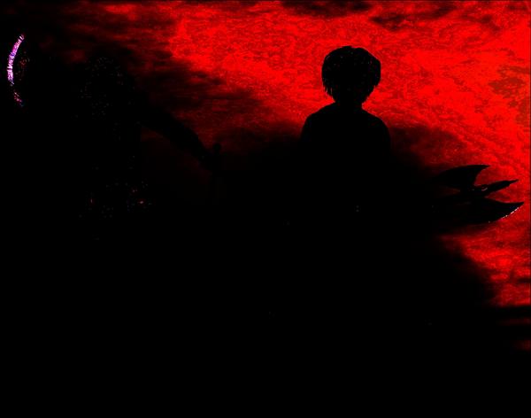

    Now what's happening?!?
    I swear, I changed nothing in the scene.
    1145 x 900 - 343K
  • WillowRavenWillowRaven Posts: 3,787
    Herakleia said:
    Besides the point, but AidanaWillowRaven - I love the Lovecraftian look to that structure. Looks like something a James Bond meance from the 80ies migt have owned.
    Thank you :D
    That looks like one light is being 'over driven' and the others are 'off' or pointing the wrong way...

    I even tried rendering with the lights completely removed. Still all red and black render.
    I tested another scene and it renders fine.

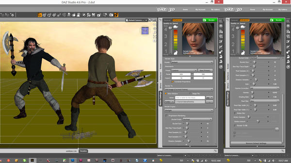

    Screenshot of render settings ...
    1920 x 1080 - 323K
    Gamma is 0.01, it should be 1 or more, depending on whether or not you've got color profiles/calibration set up, OS settings and what not. (I believe 1 is 'default').
    Whew! Thanks. I have no idea how that changed ...
    Daz also seems to be switching my raytrace setting to DSM after reload. Not sure what that's all about. And here I was insisting my lights were all on raytrace. How dare I assume Daz actually saved my settings!
    But ... even when I went through each light by hand and set to raytrace, I got the disco dots, again. So I decided 'screw it' and chose a poser light set. FM's lights rarely steer me wrong :D

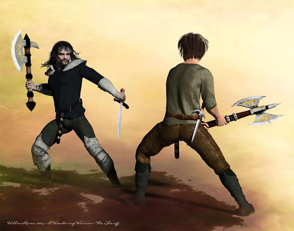

    So now that I finally have a render...
    1145 x 900 - 557K
    Finished :D
    Thanks for all the help, guys :D
