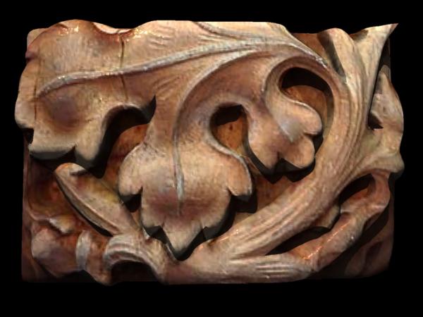

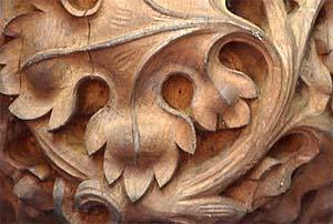

    thanks for your responses. You are right, images would have helped. I have 3 examples attached.
    Thanks so much!
    Pamyla
    300 x 202 - 37K
    194 x 259 - 6K
    242 x 208 - 9K
  • dot_batdot_bat Posts: 373
    wow! tho someone probably could model that, im not one, i would go the displacement map route for some of it but the very high relief would have to be modeled and thats way beyond my abilities. GL
    I would do all three with a combination of modelling and displacement maps.
    I would probably do the first one at an insane subdivision level in Blender and sculpt in lots of the details then bake out the displacement maps. The other two would be a much more moderate level for modelling and I'd do rough details, like the leaves without getting too 'fancy' with them and then bake/paint much higher detailed displacement maps to bring out the finer details.

    So what you are saying, for me to do is to model the basic shape and use displacement maps for the details?
    Pamyla
  • ClaywomanClaywoman Posts: 31
    I think I thought that it could all be modeled somehow..especiallly with the last 2 images...I need help with getting those details. I tried the push/pinch tool, but did not get the results that I desired
    You can model a bit more than a 'basic' shape...like for the leaves on the third one...model the outline, curve and central ribs, but no need to model the finer lines. The first one would make a very 'heavy' mesh if you tried to do much more than very basic details. The second one you could get fairly detailed without going to too high a poly count...but

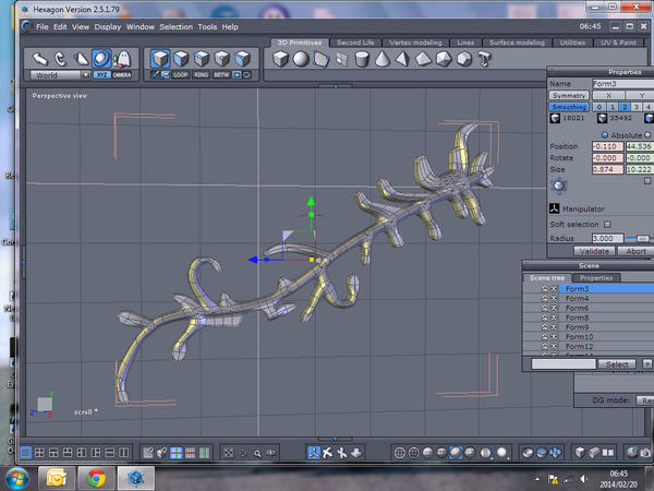

    Here's something I'm currently working on - the scroll-work on the side of the Cutty Sark. The principle is simple - outline with curves join with Ruled Surfaces. The execution not so simple :)
    Good idea to try sculpting in Blender or Sculptris, make a low-poly copy using retopo and use the high-poly normal map on the low poly version to get detail. I must try that :)
    Thanks guys. Roygee, would you then use the bend tool in hexagon to place that if it were to go onto a column?
    Pamyla
  • RoygeeRoygee Posts: 2,247
    I would use a curve to bend it.

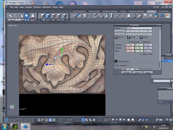

    Not having much to do this morning, I tried doing the wood carving in your picture. First did a rough layout in Hex, extruding from a single poly, then smoothed 1 level - very little detail modeled into it. Took the .obj into Carrara and projection-mapped the picture onto it. I think it turned out OK? Shows one has to sometimes decide between how much to rely on modelling and how much to rely on texturing for detail.
    I'm going to try taking it into Sculptris to sculpt detail and go the normal-map route :)
    Ditto on the curve...
    Nice job. I can't wait to see how the normals bake out...the ones I've done, I've liked...
    Awesome job on this Roygee....why did you move into Carrara? Does it have better modeling capabilities?
    Thanks, PamLya :)
    No, I render mainly in Carrara. Carrara does have a pretty good modeling capability, but I far prefer Hex.
