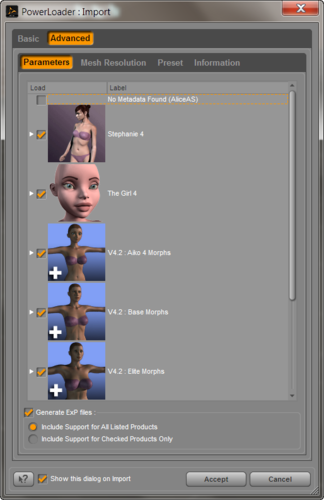

    Sorry, what I'm using is called Power Loader. It opens up every time I load the V4 actor in DS 4.6. I'm not sure if it's part of DS or if I bought it with one of the V4 or M4 packages a while back.

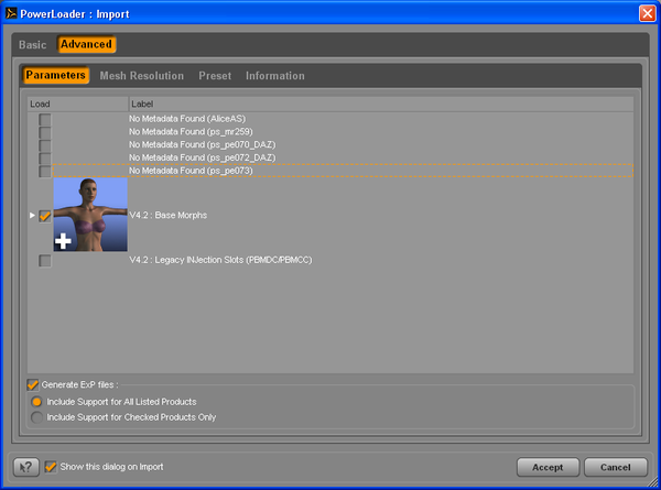

    ok I've realized I hadn't installed the power loader for Daz3....I now have it working but my morphs do not show up on the Parameter tab of the Power Loader.
    how do I get the morphs into the Power Loader?
