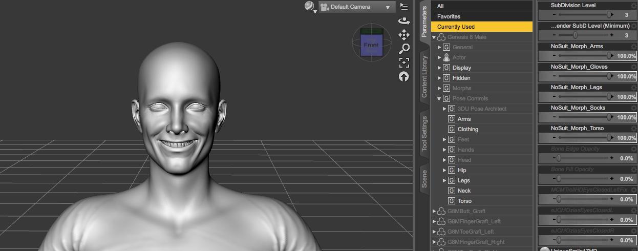

    The short answer is Yes! and the teeth are actually there.  My guess is that you still have the mouth geograft still attached.  There is a property of geografts and clothes which can tell the figure to make the structure beneath to be invisible to prevent pokethrough.  If you delete the facial geografts and dial out the facial wrinkle morphs, you should see the teeth as illustrated:
    1246 x 490 - 134K

  • nemesis10 said:
    comixfana said:
    Case in point the figure on the left is my base "Joey" model, the one on the right is the Genesis 8 figure that comes with the No Suit...I applied the same rage facial expression to both...what's with the face?  No teeth!
    That worked!  Thanks!
