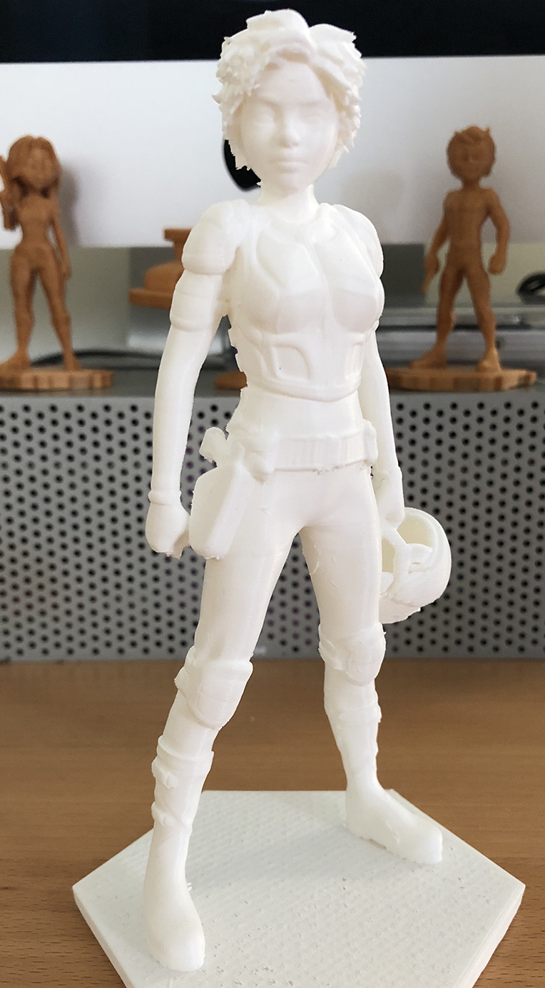

    The head height is approx 12mm (1/2") to give a sense of scale.
    Wow, the hair looks kind of good for a figurine of that size.  The Royal Doulton (fine china) people must be nervous!
    I hope people will post about the paint issue - what kind to use, durability etc. And whether my idea about making some clothing and accessory bits out of PVC (or casting the entire figure, in colored PVC, from a 3D printed mould) is of any value.

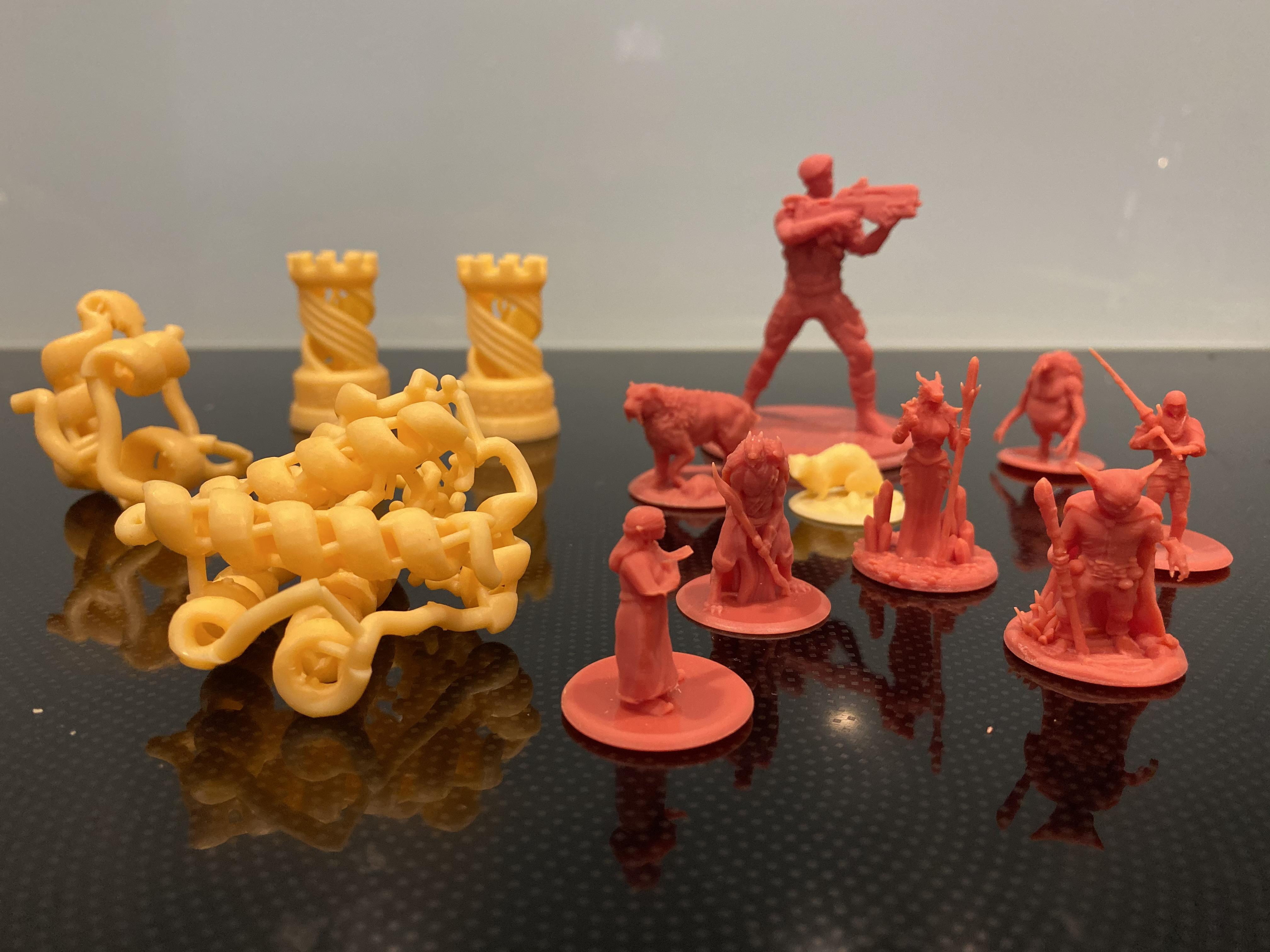

  • I can give part of an answer. If you are wanting to cast the usual 28-35mm high Warhammer type D&D figures, then
    Lost PLA will not be suitable.
    The filament printers do not give adequate resolution for that. The only type that do at a size that small are the DLP printers.
    If the figure is to be 150mm (6") or above, then lost PLA should work, but I have not tried it.
    If the figure is around 100mm (4"), Lost PLA will probably do a job, but it may be a bit disappointing.
