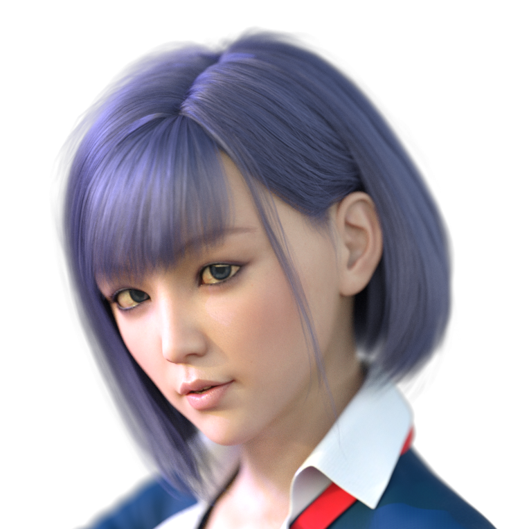

Experts help me please, I could't recreate in rendering as the product shown T_T
Could any expert tell me what have I done wrong or missing, many many thanks.
I brought :
CO Ichigo and Ichigo Hair for Genesis 8 Female(s)
https://www.daz3d.com/co-ichigo-and-ichigo-hair-for-genesis-8-females

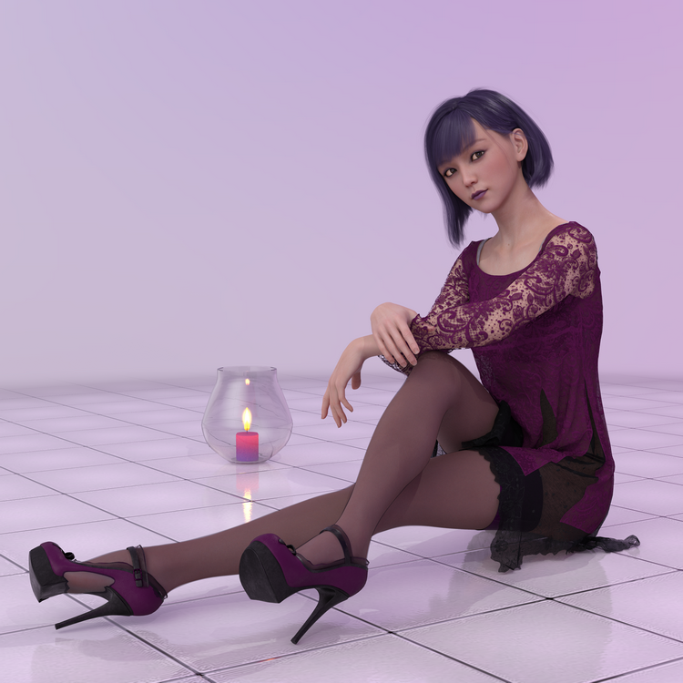

I have try to render it in a way to get back the figure they shown but no luck, in the attachment shows an highly simular position and lighting, but I found that she does not look like/same as the promotion picture, I would wonder why? Have I done something wrong? missing any thing?
even the outcome looks not bad, but it looks obvious to me they are two different person, and also missing some feeling and soul, seriouly want to ask for advise from expert here, many many thanks in advance.
also, it would be great if Crocodile Liu could give advise on the parameters and such, so that I could recreate what they selling, many thanks in advance.
Finally, I would like to say, I buy a lot of models, they may be simularm but they can be differentiate in human sense.
I would expect it is easy for me to able to recreate figure especially on their face, if I unable to get the face I intended to buy, all my buying may mix up or duplicate, because they only have subtly little different
oh, you may say just try to blur it, yeah, have done that, no luck, also have attached that for reference, you can tell they are different person
why I broder to post? Oh, because I was about to buy some other new product from them, I like it but ... ... what if I don't get what I see from what I buy, or also is good to found out: "did I do any thing wrong / missing anything?“ after so many years of using DAZ3D, many thanks to reading all these till the end, thanks again and looking for your comments.
%ps also wonder if it was render by other software, and I will never get it from Daz3D, if so should have tell me earlier  T_T
914 x 457 - 129K
914 x 457 - 127K

  • scorpioscorpio Posts: 8,533
    Lighting - your lighting is totally different to the promo lighting.
    Also thats not blur its depth of field just blurring won't get quite the same effect.

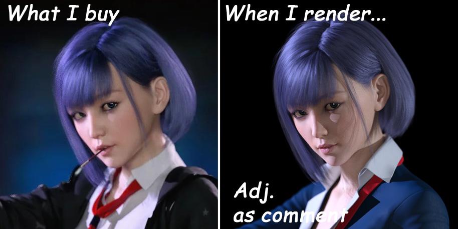

  • In this pic comparison, I have added lot of thing as suggested:(plz be patient)
     a big back light (a large vale of parallel light at the back) which have effect at all (obviously 180 phase not light up unless transparent )
    50% up environment light (don't think it helps) if too much will not same as original
    Left light up 100%, well... still same persons. You may calibrate by her hair , but face is what I am care for
    Cam! Most important part, I now put it very far 1000 away, make the focal length so unreal = 650
    Add Dof rather bur Focal Distance = 990 right in front of her face f stop as default 22.
    Conclude, 1) no feel, 2) she is not her
    (Surely left light don't have that much, please see her left noise )

    have you look ate my 1st post / 2nd picture, I did set pixel filter, and even put it in PS to blur it , pixel filter is very simular to blur, and I right?
    please correct me if I am wrong, and the post processing in PS (i.e. blur) give more flexibility, that mean can adjust without re-render.

    Just looking at the image, I don't see anything that seems like postwork.   I think you will have trouble making the image look exactly like the original since there are so many things you don;t know or don't have.
    1. Your camera settings are different; my guess is that your camera settings are at 50 to 80 mm while the promo image is 100 to 150 mm so the face shape is distorted by the focal length.
    2. Your lighting is glancing rim light while the promo image has light flooding face on which alters the colors.
    3. Your image uses a flat black while the promo has a nice HDRI which provides fill light.
    4. And finally, DOF (depth of field) was done in camera in the promo.

    To get 'the feel' the lighting would have to be better matched. Perhaps a different environment map - and a window source for it to shine through providing backlighting - and/or whether that was a draw Dome or a wall behind her to catch/reflect the light. You know, to make the aura. Softer light - softer shadows - larger light from further away.
    I took one of the sets of photos and overlaid your render at about 50% matching the ear. There is a small difference most noticeably about one of the eyes so possibly the head twist angle or ?

    in my test, I already use enironment map + distance (parallel) light already, lighting can make differnce, I agree, but not if the lighting is so closely match.
    if you think my lighting is differernt, please see post #6, + post #1 you can see that the light part under left eye is show up, it means the lighting angle is more or less the same, and the level of enironment map also adjusted to fit the left face brightness.
    so, if you say different, may be I use Env + Para Light, they may use EnV light only, but I personally think Para light has no big diffent to Env at all (effect and quality - wise), please correct my if I am wrong, many thanks
    So, you suggest the flat env + parallel light not good enough to reproduce that image? I have to get their env  map in order to reproduce the same effect? (Which is not provided, and most likely never able to remake one)
    So which angle you would like me to twist??
    You need to tilt the head sideways so the jaw-line rises up and the ears match. Then you need a softer light to get rid of the harsh shadows that you're getting across the face. Seeing both renders, I can tell it's the same character. But never underestimate how much different light vs soft light makes in the face. A perfect example to  illustrate this can be found here:
  • I'm not an expert, but from what I see:
    a) the color of the lighting doesn't match. The promo render looks like it has more yellow-ish lighting, while your render looks like it has more cold light temperature. Adjust the lighting color temperature, try maybye 5500 or something.
    b) the shadow's softness does not match. If you use point lights, make them bigger (height and width 50 or 100, just try which one feels better)
    c) your figure is poorly shaded from the right side. The lighting on her right cheek and ears doesn't match. Add a helper point light on the right of your figure and play with the intensity and temperature.
    d) You won't reproduce exactly what is shown in the promo render unless you have the original scene file with all the lights and settings. You will NEVER get the lighting EXACTLY unless you use the same HDR map, set the camera angle, lens width and DOF EXACTLY like in the scene.... I get your point that you want to render what you purchased, but... is there any practical meaning to it?
    Have you read post #6
    edited December 2019
    The posts are not conveniently numbered you know, and coming across as being somewhat sassy doesn't exactly help your cause either. PAs are not selling their promos, they are using their promos to sell their products. Some PAs provide bonus lighting sets that they used in the promos, most do not. And you know, many have VERY expensive, large systems. Now a very small 2 door car might get a passenger to the airport on time the same as a long limo might; but the resulting trip will not feel the same.
    One can find alternative hdr images to use in the render settings, environment section, many are available for free, for donation, and of course, for sale. As you experiment with different images you may quite possibly render out a superior image - one that you like better.
    Iray likes LOTS of light ... light casts shadows. If you play around with a flashlight, your hand and a wall ... the closer the light is to object [hand] the crisper the edge, further away the shadow is softer.
    Some of the other information on the Render Settings tab makes sense if you have any knowledge of cameras and lights, and yes each setting can make a big difference for the end result. When you find a group of settings that work to get the feel you want, you can save out Presets for render settings, as well as for light settings - the lights that are adjusted on the Parameters Tab.
    And then there is a third type of light ... I love this one ... make a plane or sphere, on the Parameters Tab change the black to white and it's emissive. Change to "k" something and set the cutout opacity to something like 0.001 ... place said light so that it will shed light where you want it. To make additional lights, one can use the clone feature in D/S ... use the manipulator to find and reposition each one. It is not a good idea to have the actual light source mesh in the image unless it is totally hidden by other objects - sometimes renders out as funky pixel clouds if you do.
    There are some excellent video tutorials by a Pro in this thread, one for lights here.
    And I have my own contribution starting over here for lighting via the render settings.
