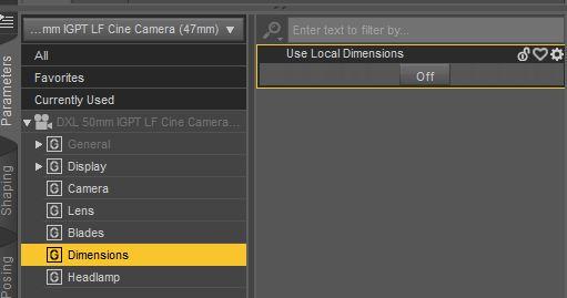

    Ok I can say I am very happy with these products. Now whether or not you need all the various sets is tough to say right now since I have not had enough time to try out alot of the cameras. For what I need in a camera this works out great, with exception of adding it to current viewport in place (a small inconvenience I am happy to adapt to). I added a camera from each set, which oddly is under the "Light Presets" from content library instead of the Camera presets. I was able to batch render each without any issue. The controls are superb imo for dof. It is much easier for me to get what I am after very quickly. For me this is a keeper and something I will use going forward in all my scenes. Here is a screenshot of the controls from the Camera focal/dof section:
    Controls
    And when using the cameras they will not change aspect ratio unless you manually turn off "Use Local Dimensions":
    local dimensions
    I have done photography for 7 years and used DAZ for 2 years. I can say that before using these cameras I had issues getting dof that I wanted out of the default camera. Often with crazy dof numbers like 934 to get the wire boxes to cover the area I wanted and still checking iRay preview while tweaking or after tweaking and side view from perspective to check the boxes were covering the areas I need. With this I point the camera then jump to the side in perspective view and type in dof and can freely move the focal distance slider without worrying about the area of focus from dof value changing in the viewport. Maybe I was just really doing something wrong with default camera but this is just plain easier for me to use and benefits me greatly in my workflow.

  • Hurdy3DHurdy3D Posts: 1,099
    how di you chanhe aspect ratio when local dimensions are off?

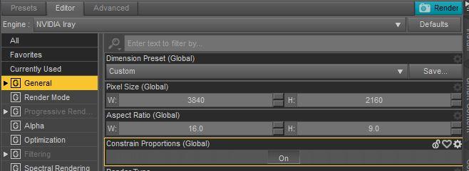

  • shaneseymourstudioshaneseymourstudio Posts: 383
    edited December 2019
    Under the render settings where you put in the resolution (3840×2160 example) you can then choose 16:9 for instance and the camera will reflect that value. EDIT: If you leave local dimensions "On", which is how IG cameras load in as default, then it will have the aspect ratios he has tuned which are excellent but my scenes require 16:9 3840x2160 so that they conform nicely when resized to 1920x1080 for my work.

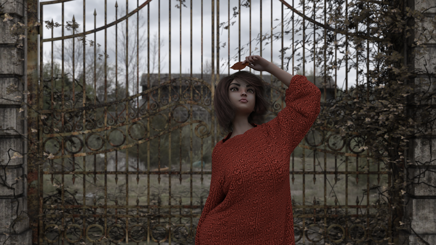

    For folks who aren't sure what the immediate benefit is out of the box, the only difference between the two images below is the camera they were rendered with. The first is the default DS camera, and the second is a camera from this set. They're rendered pretty much as they load; the only thing I did was make sure they were both set to exactly the same position.
    Camera test with default Daz Studio camera.
    Camera test with one of InaneGlory's cinematic cameras.

    Hm. Thank you for the example. I still don't really understand. Can't I just adjust the Frame Width slider on the camera to achieve the same thing?
    Yep, and if you already know how to get the results you want from the camera I'm not sure how useful they are. I actually ended up owning several tools that could be summarized as "I have no idea what 'correct' use of this looks like; please show me" because that's how I learn, and this is one of them.

  • Hm. Thank you for the example. I still don't really understand. Can't I just adjust the Frame Width slider on the camera to achieve the same thing?
    You can achieve the same framing dialing this in. What the main benefit for me is that it seems to lock/combine focal length and frame width in a way that lets dof act as I would expect so that I can punch in 1.4 f/stop and set the focal distance without the wireframe indicators going crazy as I move the focal distance. From what I can gather in the limited time I have tried them they are otherwise a ton of preset aspect/framing setups.
    That's the thing I didn't know how to answer--namely, what benefit a more advanced user would get from them. The framing setups really are useful to me as they load, but most of the confusion over these seems to be whether that's all they are. I've seen a couple of threads about these and nobody was really sure what "acts like a real camera" meant.

    i really like the subtle DoF in the second one there, the one you used the cinematic camera with. I use dof a lot, but truthfully, yours looks a lot better than what I achieve on my own. I too, have been curious about these cameras.
