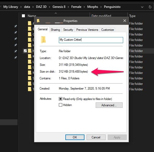

  • As a reference for comparison, according to Win 7, my ...\data\DAZ 3D\Genesis 8\Female\Morphs folder contains 5.318 files (4.882 .dsf files (morphs or controllers), the rest are HD morphs additional files, morph icons etc.), 77 folders and is around 912 MB big (on disc). Loading time for base G8F is around 17 seconds. Loading time for a character for G8F is around 20 seconds.

    One thing to check is for any unintentionally bloated morphs package.
    For instance, I do a lot of custom homemade figures. Once in a great while, I wind up with a massively bloated morph directory taht in turn bogs down the figure when it loads. Here's how to check for this:
    1) go to My Library\data\DAZ 3D\Genesis 8\Female\Morphs (or on a Mac, My Library/data/DAZ 3D/Genesis 8/Female/Morphs ).
    2) start with any custom stuff you made... for instance, I'd go the .\Penguinisto directory in there and look first. Otherwise, well here comes the tedious part...
    3) grit your teeth, get a cup of coffee, go through all the directories in there (commercial ones too!), and figure out "size on disk" for each. On Windows, this means opening up "Properties" for each. It helps to start with recent purchases and recently-made custom characters.
    You'll see something like this on a good one:
    The size you see here is typical - less than a MB or so - sometimes a couple of MBs at the most in exotic cases.
    Now for the fun part - if you see that size as something ginormous, say, 2GB (my last bug-generator), then something is heinously wrong, and that directory's contents are your likely culprit. I usually move that whole directory to another place (like "D:\temp\"), make notes as where it was originally, then restart the machine to clear all caches. I then reload DS, and load up the problem-child figure (Base G8, Base G3, whatever.)  I move it first just in case, which lets me put it back if the problem didn't go away.
    So, if that fixes your issue, yay!
    Bad news is, that particular character you just removed is gonna be unusable in DS. If it was a vendor-supplied character, just re-download, re-install, and double-check that the morphs directory isn't bloated.
    If it doesn't fix your issue, well... gonna have to try something else.
    589 x 582 - 142K
    Post edited by Penguinisto on
