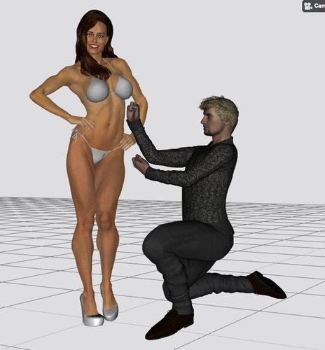

Hi guys, working on a new issue I've been trying to tackle for several hours now -- created an image the look/color of which I love in viewer window of DAZ… but once rendered, it's a completely different color/contrast that just doesn't work for me.
-- Tried playing with light settings; any setting I turn on seems to result in completely blacked out renders.
-- No lighting at all does render my image, but it renders it MUCH darker than I need it, messing up Gia's face to boot -- regardless of how light I try to make the skin of my actors, this seems to make only the slightest difference.
I've attached a screenshot of what I'd like to render, and the actual render I'm getting when I'm seeing this on my DAZ desktop.
What am I doing wrong and how do I fix this? Super frustrated, any thoughts or ideas would be SO much appreciated!
Thanks in advance.

  • JaderailJaderail Posts: 0
    Your OpenGL Viewport will NEVER match the 3Delight render. You will have to learn lighting in DAZ Studio. The Fast render with no light is using what is called a Headlamp (light) that is built into the Camera when no other lights are added to a scene.
    Just so you know Lighting in 3D renders is one of the hardest things to learn. But there is lots of info posted in the forums on lighting. There is no fast way to get things perfect.
