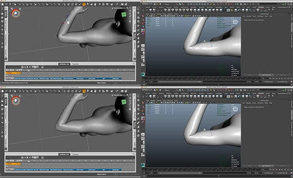

    I've attached an image; on the left is Daz, with and without corrective deformations; on the right is maya, with and without subd.
    It's clear the deformations aren't subd.
    Any ideas where they may be coming from? Do these look like the native deformation for genesis 2?
