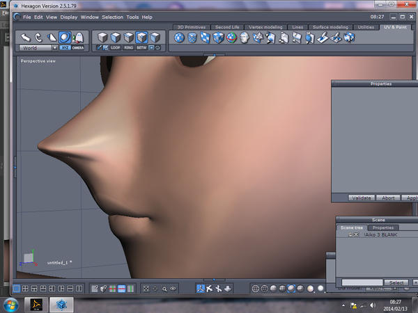

    Something like this?
    I symmetry mode, select one vert deep in the nostril and expand the selection until all nostril verts are selected. Make the size in the properties panel 0 in all axes - that will collapse all the verts to one point. Move the point to be flush with the nose, then using soft selection, make the nose pointy. Give it a light brush with the soften tool to even out any creases.

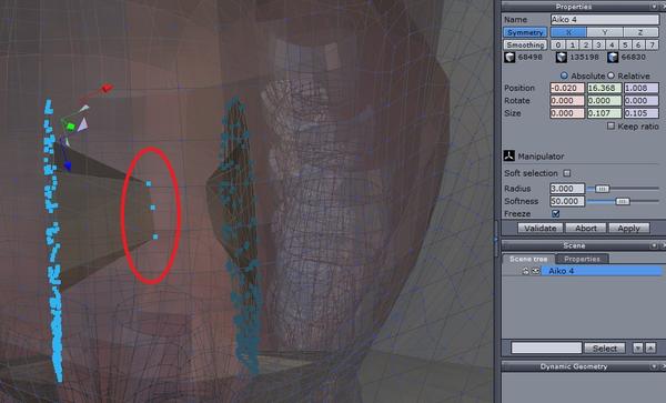

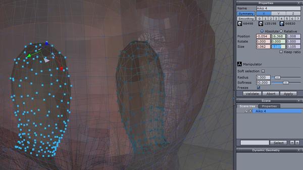

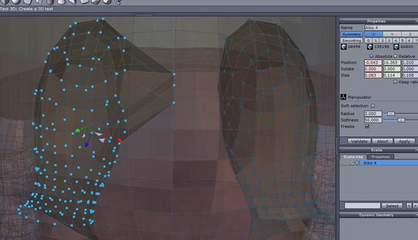

    Is there a "zone" around the symmaetry line that will pull close vertices onto that line? Here at two pics, one is selecting all of the vertices, and then the second is when I set one of the "size" to 0. You can see 3 vertices "snap" to the symmetry line. This happens not only when I do this, but when I even touch that selection of vertices. I searched through the manual relating to symmetry modes, but I don't see anything about turning that off?

  • RoygeeRoygee Posts: 2,232
    You need to set all the axes to 0 before seeing the proper change. As Jimmy has pointed out, the verts collapse to a single point in 3D space, but they are all still there and the count doesn't change - I've tested and Studio accepts the change as a morph.
    This is the standard method of making earless morphs.

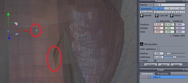

    I did try before replying it was just easier to see without doing all axes, see below...those three collapse to one but still seperate from the group, snapped to the line, and you can see those three over on the right as well...
    927 x 413 - 109K

    Argh! I completely reloaded and reselected from scratch and those 3 point still snap to the line. There must be some setting that I am missing..?

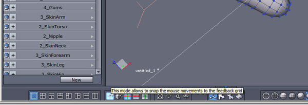

    The only thing I can think of, is the Snap to Grid function as shown below. If you unselect that, does it still snap?
    778 x 264 - 67K
  • 3dOutlaw3dOutlaw Posts: 2,083
    edited February 2014
    No, that is not selected.

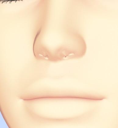

    So here is my first outcome...this is using a shader without a map, as I thought that would address the stretched UV issue, but I guess not.
    I assume I will need to not stretch the mesh so mush when I do this, and just make a really small point where they are stacked...so that it is less noticeable?

    re your previous post - just tested on a very dense mesh - I don't get any snapping to the centre line...
    You shouldn't be getting the pinching - have you tried giving it a light brush with the smoothing tool?
    PS - another though - you have possibly gone too far to the outside of the nostril with the selection?

    I tried again on A3, and actually got a decent morph! Bad thing is, I cannot now get it to save as anything usable in Daz Studio. In DS it is a Morph, that I can dial up or down, but I have tried to save as a deprecated Poser Preset and a deprecated character preset, and neither do anything if I fire up a new DS, load A3 and try and apploy them... :(
    Any thoughts?
