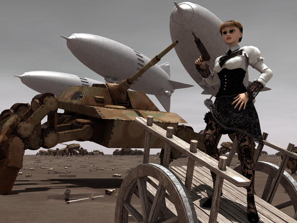

    BTW, you can load large scaled objects in the medium scene just fine. The will be very large of course, but it's a great way to add scale to your scene.
