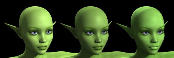

5. And finally, going back to surface settings, can I ask for advice on the picture. It's a simple UE2 and 2 spotlight setup, but I've played around with different skin surface settings for each option. Can I ask for opinions on which version is best, why, and what I could do to improve. I know there's never a single way to do things right, but like I say I'm just looking for opinions and options.

    5. My personal choice would be the 3rd. The others seem to lose a bit of detail with the settings.

    5. Personal preference, I suppose and it varies based on monitor setups, etc. For instance on my laptop, your images showed much differntly than they did just now when I put it back into the docking station and viewed it on my monitor. Since you asked for preference ... I like the middle one as it feels a bit richer in saturation and the lips stand out better.
