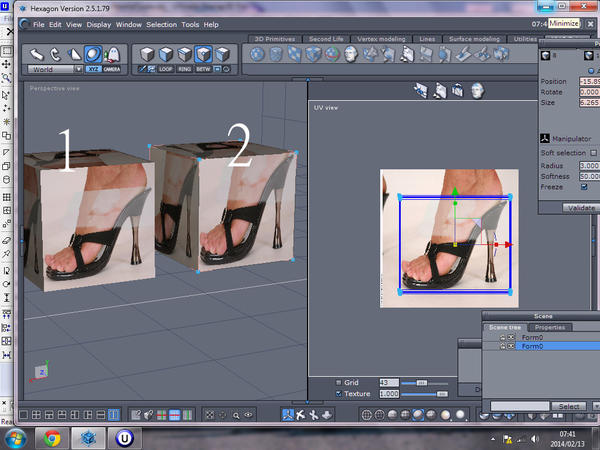

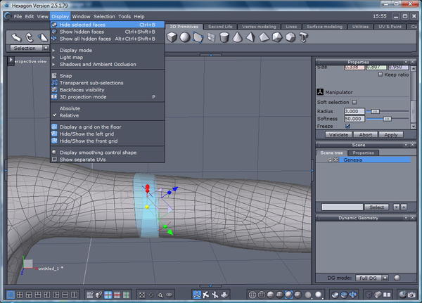

    1. You can hide polygons you dont wish to be moved, which wont lock them, prevent them from moving, but it will make their edges sort of more visible, more pronounced. So, when you make soft selection, if you select edges of invisible polygons, that would mean that you selected to much. (pic 1)
    3. You can use your UV template image as texture image for the material which will than show in UV view if you have Texture option active(pic 2). You will probably have to flip the image vertically in the material setting and increase image visibility in the UV view (slider next to texture option). Also, image will be visible in UV view if you have (whole) faces/polygons selected. When you select edge or point image wont show, so you will probably have to switch between selection modes during UV adjustment.

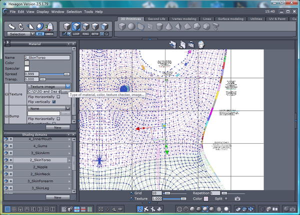

    You can load an image to show where the "CheckerT" is. Have "nothing" selected and over in the materials tab, tell whatever material is showing, to carry a texture image. Then select the desired .obj and also have the same texture image applied to it. Then being careful to have the uvmap window "active", IN the uvmap window, one can move the dots to the desired locations.
    n.b. Because of burps and bits with the program, one might have to start with a freshly opened Hexagon to get the materials showing when "nothing" is selected. Once a material is assigned and Enter is clicked, the group tends to vanish but is really still there ... just showing when .obj is selected. Alternatively when 'nothing' is selected -- one can make a "new" material and apply the texture image to that. Program should be then showing that image instead of the checkers.

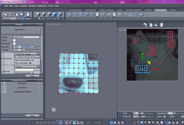

    Seeing what Patience wrote, I recalled a tut from Geekatplay where he shows how to move points on the UV map to match the texture. This was possible in previous versions of Hex, but in the current one, the texture vanishes when selecting points, so I never thought of that method as being very practical.
    However, it is possible in UU3D, so I did a bit of an experiment. Mapped and put a texture onto a cube in Hex (when I selected the points, the texture vanished) Exported to UU3D, saved as a new .obj - back into Hex, made a copy, then moved the points on the copy to change how the texture was mapped to the cube, so as to exclude the ankle and it worked just great.
    So, a possible solution to the OP's question is to use a dedicated UV mapping app - this would probably work just as well using the free UVMapper or Blender.

    Hmmm ... maybe we've found another bug. Selecting dots to move works on my computer, latest edition of Hexagon.
