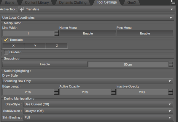

  • RenpatsuRenpatsu Posts: 828
    edited February 2014
    This should be "Skin Binding" in the Tool settings, like Richard already thought of. Just turn it to "Full" and not "Optimized" with the translate tool.
    614 x 424 - 51K
    Post edited by Renpatsu on
  • Miguel2121Miguel2121 Posts: 27
    Thank you. It really helped.
